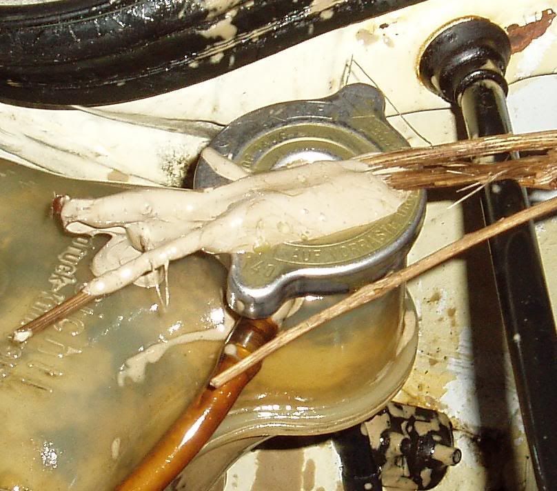

I have just joined the prestigous Mercedes 190 E owners club - 1992 (K reg) 1.8 auto 260000 miles(!) but after 2 weeks I seem to have a major problem that I would be grateful for some advice. I have had very little 'mechanical' experience and had hoped to learn on this car but did not expect it to be quite this soon.
Essentially the car starts well and seems to run really nicely. The other day the coolant level light came on briefly and then went out on my daily commute. When I checked the water levels the system seemed to need approx 500ml to top it up (2 weeks before all was OK). Oil level is OK and pressure is OK (3) and temp is always approx 80C - never more. The next day I checked the coolant levels again and the tank was full of an off white/beige thick emulsion (see photo). This was clogging up all the pipes and the water pump was starting to make an awful racket. I tried to drain/clean out the top end of the system (pipes to radiator and thermostat) and then to top the system up temporarily with water. The water pump noise went away and the system seems to run OK again nice and quiet, power OK etc.
Looking through the threads it sounds as if it may be the head gasket - however there is no trace of water/emulsion in the rocker box/oil filler lid or on the dip stick. One thread suggests that it may be the autotransmission fluid but according to the dipstick this seems to be OK and the fluid is a nice and clean red colour.
Is this most likely to be the head gasket and if so should I stop running the car immediately? How much is a gasket set likely to be and where is the best place to buy them web/local motor factors ( I am in Cardiff by the way)? I have just bought a Haynes manual off Ebay and do not mind having a go at fixing this myself as I suspect an garage bills will be far in excess of the value of the car.
Thanks in advance for any help and advice here.
Mark

Thanks guys, so it definitely is the head gasket then? If so will I also need anything else other than the actual gasket set? I have heard that certain nuts and bolts are always so corroded that they always shear/need cutting off and so I will need those as well. Will I need a hoist to lift the head or is it something that can be done by hand?

There is a simple test for combustion gases in the water system that can be carried out by any competent mechanic. They may charge you £10.00 for doing it but it could save you a lot of expense if it is not the head gasket.
Before you start the job (if it is the gasket) find a good machine shop that is capable of skimming the head for you before it is re fitted. If you fail to do this the gasket may go again quickly!
I drove my car for quite a while (nearly 2 years) with oily coolant, I flushed it regularly, (fairy liquid in the coolant tank for a day before hand really thins the mud out) but its a pain so if you can, just get it sorted! And it will only get worse, and worse, and worse....
You can still drive it, (I even raced mine up the strip at Santa Pod!!) but if you are a little more sensible than me I'd just get the job done as soon as possible. Im sure its a long trip to the motorfactor by bicycle! Head gasket set is quite cheap from GSF, and if you are mechanically minded you can do the job yourself etc.
If you have a mate who can help you can lift the head off you dont need a hoist or anything, but bear in mind it does come off complete with intake & exhaust manifold complete (you wont be able to take off the exhaust manifold while on the car, the bolts are a pig to get to). So you'll have to separate these components later on the bench. Possible with an angle grinder if your exhaust manifold studs were as bad as mine, on a 260,000 miler I would say they are!!
As Ben said you will need the head skimmed to make sure its flat for the new gasket, but the guy doing all my cylinder head work said that was only about £60..

Thanks for all the useful feedback and thoughts all. I guess it is likely to be the head gasket as I have checked the service history and it has not been changed in 260000 miles - infact nothing engine-wise has been touched for the the entire lifetime of the car apart from plugs, filters, oil and a timing something or other so testamant to German engineering.
Anyway, one quick (and final) question. In order to see if it really is the head gasket gone could I connect the transmission fluid cooling pipes together and thus bypass the radiator altogether? Then run the car for a bit and see if the emulsion returns in the coolant system (having flushed this out) or am I likely to completely knacker the transmission if I run it with no cooling?

Thanks for the advice which I followed over the weekend just gone - I should have said, sorry. At the moment I cannot see any leaks at all in the system (unless they are hiding like yours was or at the back of the engine/internal cabin heater) and I wondered if the 500 ml or so that appeared to be lost was somehow blown out when the oil/water started mixing and maybe the system overpressurised or the rad. cap needs replacing?
