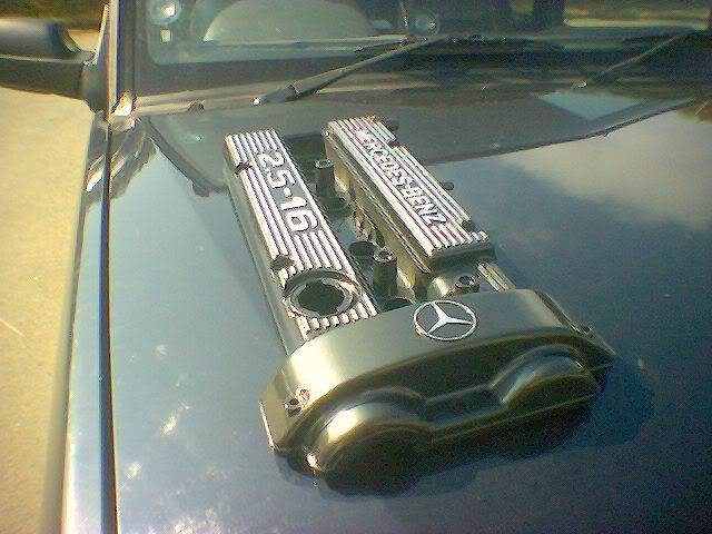

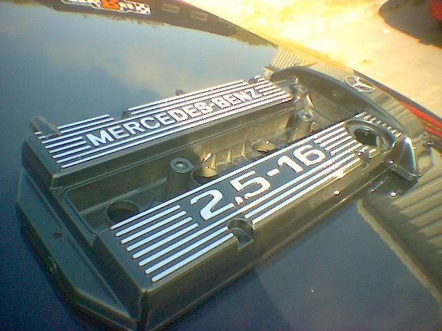

Big Ben
Just a couple of pics of Nicks finished Rocker Cover for you.
(Taken with my cra--- camera phone)

tasty pics Big Ben...
thats exactly the look im after...But i'd like it finished in the OEM colours which i think are Matt black?

Hi Bud
The OEM colour is actually a sort of non descript gloss black with the markings highlighted in silver paint! Its applied so thickly it hides all the casting blemishes and blow holes on the metal surface.
The paint we used is a :ph43r: Ssh bmw (whisper) pearl black to highlight the machine finish on the markings. Loks really good in the flesh.
If you go the route of powder coat make sure that you use a high temperature finish as the cover gets really hot next to the exhaust manifold. Also remember to mask the cover carefully where you have mating surfaces as it goes on quite thickly and will cause problems. You can still get the markings machined to give a bright finish so long as you carefully pass a flame over the edges of the plastic coating to seal them.
Much more durable than paint but wouldnt be my choice as you cant polish it!! :lol:
