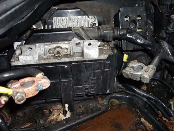

I can't find the OVP Took the battery out, behind it I have the ECU's, A funny thingie over the right hand side, a black large relay unit over the left and a selector switch similar to the S/N one for fuel type. I checked right down behind the black realy thingie and there is nothing there. Any ideas ? I checked over the other side of the car by the fuses and the extra relays and its not there either. I assume its meant to look like this ? http://cgi.ebay.co.uk/ws/eBayISAPI.dll?Vie...em=160086673749 Some pics of my ecu area. ![]() ![]()
| cossie connoisseur | Thu Feb 22, 2007 4:26 pm Post #7 |
Bottom pic look at the left there is the top of it in the picture. it slides into the ECU housing
Its between the fuel pump relay and ECU housing! silver body, retangular |
| kentronix | Thu Feb 22, 2007 4:36 pm Post #8 |
a ha, got it. I thought that was the side of the ecu. Cant get it out but will try again a bit later, I really ought to do some work for once Here is a pic in case anyone else is dumb enough to not find it ![]() I flipped the top open but cant get the fuse out, and the unit itself is held in tight, I assume I have to take the ecu's out to get to it ? |
| cossie connoisseur | Thu Feb 22, 2007 4:43 pm Post #9 |
The clear cap is on tight but does come out with a little force. The OVP slides out vertically but be caredfull not to strech any wires. The pins will be very firm in the terminal block but with persistance (and removing other things in there to get to it better) you will get it out. Might i add that you take the ECU's out and there bits in there and give them a clean cos it DOES make a difference to the running of the car
| kentronix | Thu Feb 22, 2007 4:49 pm Post #10 |
phew, a bit of effort and 2 scraped knuckles later
Got it out, the fuse is fine, is there a way to test the unit ? |
