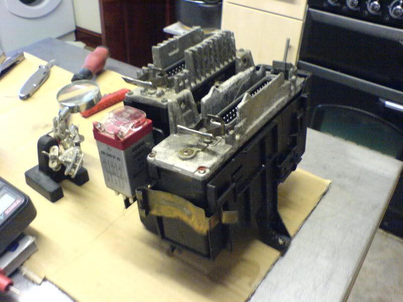

This pic may help!
Cossie 2.5
I appreciate that... I guess it's not to be! I'll post it up in classifieds as it will fit into pretty much all other 190s!! (Typical!)
That picture is from your 'clean up' isn't it?
I have to go through that process... I am really hopeful that it will solve my performance issue (turbo lag feeling)... any tips for the novice?? I've got all the cleaning products etc. Need to take it all apart and check it all for dry joints... My plan is to do the same thing with the OVP Relay... Any advise would be extremely well received...
