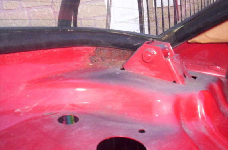

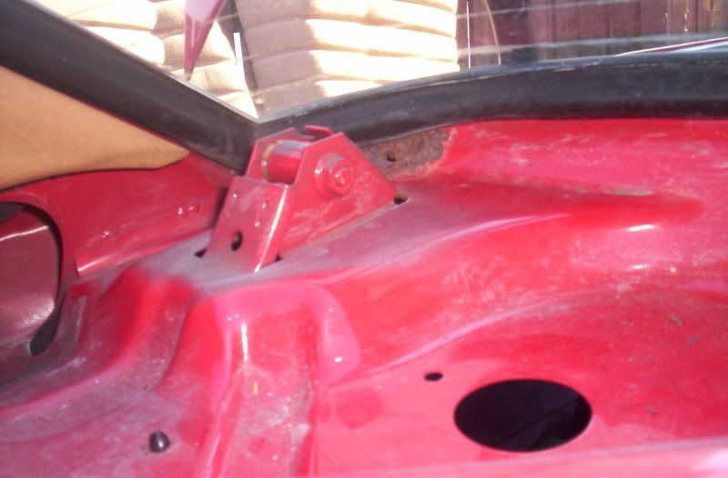

Thanks to you guys posting pics of rust on rear parcel shelf and under rear window, I had a look at mine and caught it just in time! I put some "cure-rust" on then spryed WD40. I will check it again in the spring.
BOBBARBER

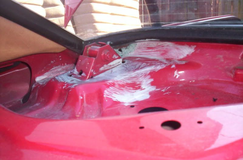

Posted ImagePosted ImagePosted ImagePosted Image
If it is "just" surface rust, then try 32% Hydrochloric Acid. then rinse off thoroughly and seal.
Use all safety measures.and nessesary precautions.
Jeremy :evo2: :driver:
BOBBARBER
when I am back in there in yhe spring Iwill try that.
Bob sorry mate but thats a window out only option :-/
no getting around it the lips will need re welding in
not to hard though
if you want to keep the car then this is the way forward, if not patch it and flog it :blink:
