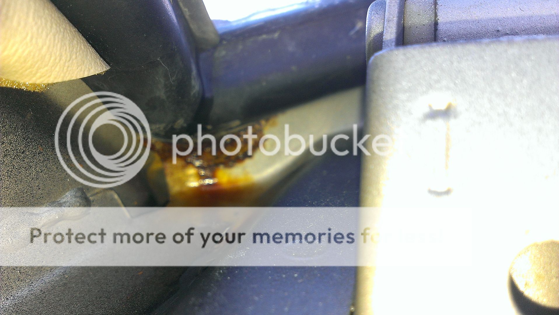

| Mork | Sat Feb 8, 2014 10:32 am Post #38 |
This is the worst of the rust from what I can see. It seems quite solid, so hopefully it's mainly bubbling. Going to have to give it a go I think. [IMG][URL=http://s939.photobucket.com/user/mork1973/media/Mobile%20Uploads/2014-02/IMAG0802_zpsqmt1pegd.jpg.html] [/URL][/IMG]
| Mork | Sat Feb 8, 2014 1:37 pm Post #39 |
Does the metal trim separate once the window is out? How do you remove it? |
| MBZ190D | Sat Feb 8, 2014 1:39 pm Post #40 |
It pulls off once the window is removed mate |
