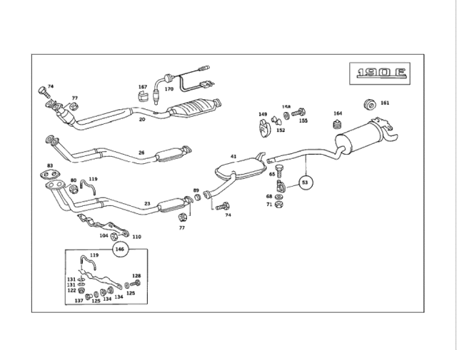

Hi all How do I tell if my '91 190E 2.0 manual has got a cat fitted or not ? Thanks Andy |
| Lewis 190E 2.5 16 | Tue Jun 26, 2007 11:31 am Post #2 |
On the downpipe you will have a box, on the box check that it has a oxygen sensor going to it, if you have then its a cat. Here: look at the top of the drawing you will see what the cat looks like.

I would have thought it had a cat, yeah. Being on a 91. Just check the downpipes or check for the EZL Edited by Lewis 190E 2.5 16, Thu Jul 10, 2008 10:44 pm.

| malco | Thu Aug 2, 2007 7:01 pm Post #9 |
Stupid question, but what is part 41? I thought it was the cat? |
| Lewis 190E 2.5 16 | Thu Aug 2, 2007 7:56 pm Post #10 |
Middle box/centre box |

| cosworth2.3owner | Sat Aug 18, 2007 12:45 pm Post #14 |
Hi, Just wondering what this part is called ?
| Lewis 190E 2.5 16 | Sat Aug 18, 2007 1:12 pm Post #15 |
Downpipe |
| Big Ben | Sat Aug 18, 2007 1:14 pm Post #16 |
Its an expansion box which helps to smooth the flow of the gases through the silencers by reducing the intensity of the exhaust pulses. It lets the silencers work more efficiently! It is, as Lewis says, part of the downpipe assembly. |

| shrink | Thu Jul 10, 2008 7:26 pm Post #19 |
sorry to resurrect an old thread, but that switch above for the ignition timing, that is supposed to be between the ABS and the front shock, is not there on my car, should that be the case? |
| Lewis 190E 2.5 16 | Thu Jul 10, 2008 7:28 pm Post #20 |
You will not have a CAT then. Only really late cars had a CAT, circa 1991-93, it was an option on older 190's but never really "opted" for... |
