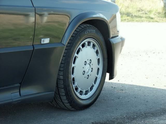

Am I right in thinking that is not exactly the same as the main body colour? Like a 'satin' version, not as glossy? Thanks, J |

Its more of a matt colour, as seen here:![]() Most repaint the bottom half to match the car, some times the finsh of the kit is lost. It will be nice to get that finsh back as it really suits the car. Lewis |
| Neil | Tue Jul 3, 2007 11:04 am Post #3 |
The point of that finish is that the paint is slightly flexible, and more chip-resistant than the metal body. If you just paint it with a standard Satin finish, it will look like sh!t in no time at all. If you can get the proper protective paint as originally specified, and make a proper job of it, then go for it, otherwise i'd go body colour gloss. |
