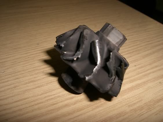

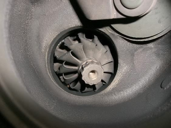

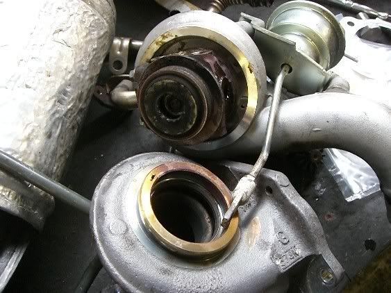

Conrad
I thought you might appreciate this one, Jesper.
http://www.retrocarclub.co.uk/forums/index...wtopic=7396&hl=
'Retro Richard'
Thought this may amuse some of the Sadists out there. Customers car has had a serious oil leak which has been ignored, less than 2L of oil left in the sump, ( should be closer to 5L)
philhoward
I think the technical term is "mullered"...
Racing
Member
What´s worse conrad,i´m sorry to say,is that it´s all to common.
