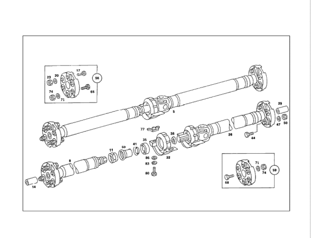

| triggerhorse | Wed Oct 31, 2007 3:39 am Post #1 |
Anyone who can tell me whether this job should be done by a mechanic? Dealer wants $300 US --not including the parts cost. |

| triggerhorse | Wed Oct 31, 2007 5:05 am Post #5 |
Thanks! Have you done one?-- I don't know if I have the tools. Any specialized ones needed? Any tips? |

| triggerhorse | Wed Oct 31, 2007 5:29 am Post #7 |
Thanks. Do you know Where can I get pictures or diagrams? |

| kentronix | Thu Nov 1, 2007 1:58 am Post #12 |
I did mine in about an hour on jacks. Tbhat was before I knew what I was doing. You have to get right under the car so you should be on ramps or axle stands at least. Head under the car roughly under the gearlever. I would suggest rais the car high and then lift the gearbox slightly with a jack to make it easier. Take off any shielding you find (mine had none so I dont know how). Then you can see exactly what to do. You should find you can get to all the bolts using an allen key and a socket. Have a look (or take a pic) of the situation so you can be sure you fit the new one the correct way round front to back. You have 5 or so bolts to undo and redo. My advice from my experience is to take it apart and then take the part to get your replacement. I have done 2 of them and neither have been the part number I expected. I have some under car pics if you need them ? click email to trigger me to post them, next few days very busy. |
