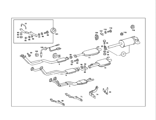

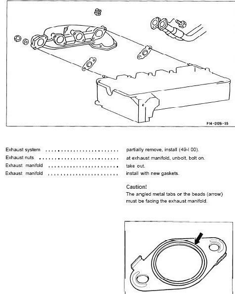

| Lewis 190E 2.5 16 | Sat Nov 24, 2007 4:53 pm Post #6 |
Downpipes for engine 201.018 ![]() Manifold for engine 201.018 ![]()
| philhoward | Sat Nov 24, 2007 5:09 pm Post #7 |
Just looked at the Rassian site and it does show "something" attached to the exhaust manifold which might be a nut? If so, just hope i can drift it out without smashing the manifold...Did just have a "feel" and there seem to be 3 flats of a nut, but maybe captive by a machined recess in the manifold? Which has the higher coefficient of expansion from heat? Steel or cast iron? Do I heat it, or freeze it? |

Thanks for the support, chaps (as always) - both technical and moral! After a good nights kip, things are usually clearer. Out with the blowtorch for a bit of gentle warming of the manifold. Back under the car and with a suitable drift and extension out popped the "captive" nut, complete with the first snapped bolt. For snapped, read rusted to half thickness in the middle, so no wonder it snapped! Out with the other two duff ones, in with 3 new bolts (managed it solo..just) and a refurbished 4th and away with the rest of the job... Slight blow from the manifold to dowpipe joint (will nip them up once it's had a short run and settled), need a new centre o-ring (chipped a bit out of the old one when fitting it...) and still the second loop hanger on the back to do (how tight??!), but its on. Way hey - the 1.8 is now de-catted! Full 190E 2.0 new exhaust courtesy of ebay for £50... Now to sort out the firework display..post in the ignition section...BTW, does anyone else keep all their "black museum" bits for posterity - even though they're no good to man or beast?? or is it just me?
