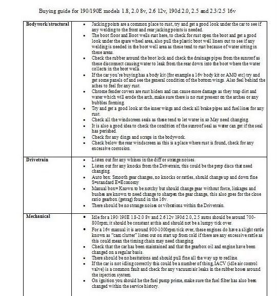

165k is nothing for one of these 5cyl diesel engines good upto 300k+ if looked after...

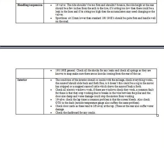

As for the windows it may well be water damage to the motor, you can take them apart and clean them up or replace them, also the wires sometimes break between the door and the post...
92, so its near one of the last (production ended in 1993) so should be a rather solid example...
Heres alittle guide on what to look out for:

for £400 if its got no mot i'd walk away
look at all four jacking points under the car as they like to rust there.
inner wings, under the water bottle and washer bottle (easy to remove to check just undo a big plastic bolt by hand to lift the washer bottle) and around the seal at the bottom of the rear window.
check boot under the spare as it rots there if the back window or seals have been leaking.
front wings rust and around the back number plate area/ back lights /number plate lights and boot seal area.
