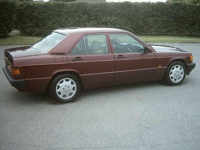

Thanks to you all for being such a great help. I am sure I will get to know the car in time but it gives me so much more confidence to know there are people here happy to provide such good & honest advice. I am going to get under that bonnet tomorrow and take a look at the return spring. If it is not present are they easy to get hold of? Cant wait to get this fixed as it spoils the experience somewhat. I have been looking through ebay to find a slider switch plastic button for the Air Con control. Mine is missing and would like to replace it. Any ideas where I can source one? A small picture of my pride & Joy below. I have not seen many other LE's on here, any ideas how many were made? Thanks so much. ![]() |
