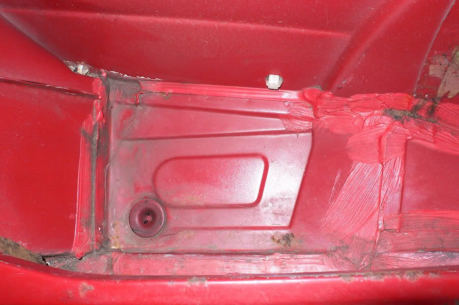

Hi mate.
Remove the inner boot liners, as described here
You should find a removable rubber plug in each side. It's probably blocked.
Take it out, clean it and replace it.
You might have a little rust in there, don't worry it can be sorted.

sorry, forgot my manners, neil, great foto, explains everything.....thanks.

thanx all, for your advice,peeled back the boot trim,shovelled 19 autumns worth of
leaves, dead squirrels and a "frankie he says relax" t-shirt out into the daylight
then i prodded and poked until i could feel something wet on my timberlands, and
lo and behold, no rust, either side! I was almost expecting to see the axle, but all i could see was boot floor, Deep joy.
After paking it in the sun, well, out of the rain, for a couple of hours i could finally
drive, and, see out of the rear window, now, if only i could see forwards as well.............
