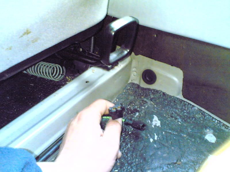

Got the exhaust system from Julian and it come with the sensor on it, the exhaust is on the car but I did not find the conection for the sensor on my car but instead I got a plug in inside the car just in front of the drivers seat and I wonder if this is the connection for it.

yes papa, thats the connection for the exhaust sensor. |

There are 3 wires coming from the sensor, 2 white 1 brown any idea which one goes where? |

If your car didnt have a lambda sensor on it in the first place, you dont need to plug the sensor on the new system in papa. |

if you need to plug in the sensor,the socket end from the sensor has a half round raised portion this should be facing upwards when connected, the single wire then goes into the round connector, hope this makes sense. |

Thanks guys. I only had 3 wires coming from the exhaust and I finaly figured it out how they should of been conected. Took the car for a ride and it seems a lot smoother and more responsive. |
