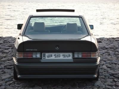

really conrad, thats good news. my 190 is 1993 so its one of the latest. i TOTALLY agree with you on the twin exit pipe, its much nicer than a circular one. although on my car the rear bumber covers the exhaust and its really low so that could cause problems. |

Nope, you can get a sports cat. If you take it out your car will fail MOT (or whatever your equivalent is) on emissions. A sports cat will allow free-er breathing. Whatever you do don't cut that bumper. You can get them to hang it lower or do what Nick did and get a stainless steel one in the same shape as our standard, so it stops before the end and remains hidden, yet still gives you advantages. |

i suppose the sport cat will set me back a few extra quid but i dont min tbh. id be more concerned about the end product ie. the noise. i just had a look there and maybe, just maybe we might be able to squeeze the tailpipes under the bumper. as the car is lowered the front is really low due to the design of the front bumper. but the back bumper is actually a lot higher. so im off to price a backbox and a sport cat so. you reckon magnaflow would be my best set yeah? as ye can kind of see below there isnt a wholepile of space there for an exhaust.
