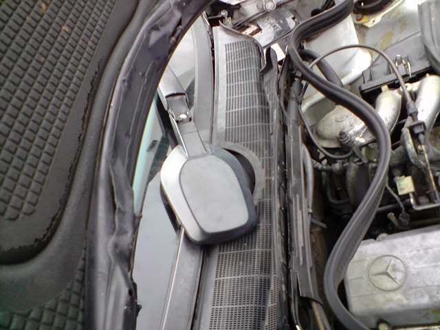

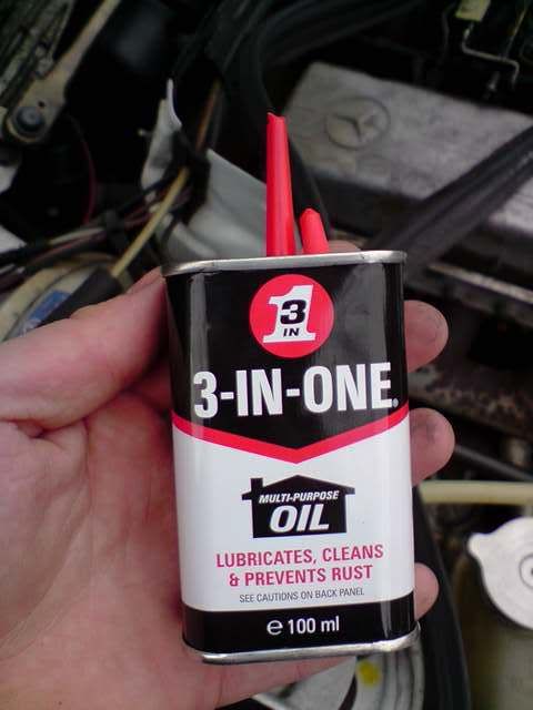

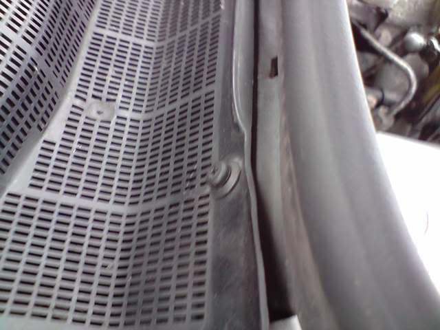

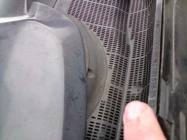

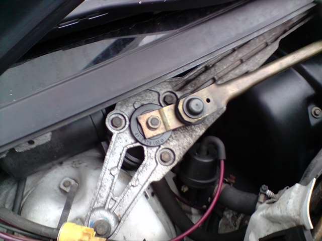

Right start by fully lifting the bonnet, next remove the 2 seals as shown in the video, then remove the bolt i point to in the video, there is one either side and they are 8mm. ![]() Now you need to remove 2 Phillips screws, but don't remove them all the the way, when they are just about out pull the screw and it'll bring the back part of the clips out. ![]() Now remove the cover from the wiper arm as show in the video. ![]() Now remove part of the bulk head seal the remove the scuttle panel, as shown in the video. ![]() Next turn the ignition on and start the wiper then turn the ignition off when the wiper get 1/4 of the way across the screen revealing this ![]() This is the oil i used ![]() This video shows all the parts i lubricated, ![]() Now start the wiper up and let the oil work it's way into all the joints ![]() Now you can put it all back together the wiper has to be either 1/4 or 3/4 across the screen to slot the scuttle panel back in. i hope this guide has helped you, and i apologies for the poor videos I'm a man it's hard to multi task :lol: Here is a few more pics i took. ![]() ![]() Nearly back togeather. ![]() Make sure this seal is on the outside as shown; ![]() Job Done! |

Not to be picky, but that will just be a temporary solution. btw, thear is a gasketseal just wear the arm goes inside the gearhose, so the oil will just drain away after a coupel of times. IF the wiper have a problem to make a smoth, quick wipe, its the gear-grease inside the gearhouse thats need to be re-newd whit new gear-grease. GREASE is the only alternative, oil will leak out. I have done this 2 times and its makes huge differens. |

I'm not so sure on how you've done it.... feel free to correct me, but if you take out the wiper mechanism there is a sliding mechanism. If I remember correctly a metal arm which reciprocates in a rectangular slider housing, this is surely the part that needs greasing with a proper grease that won't wash or drip off? |
