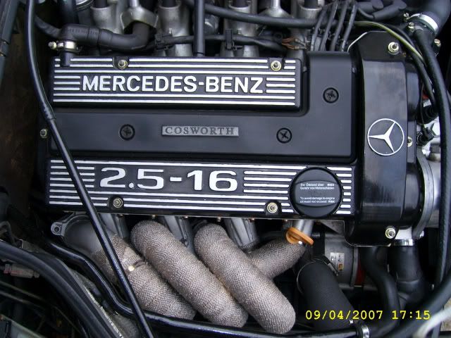

| ROBINWALSH | Mon Apr 21, 2008 9:12 pm Post #10 |
hers some pics of my wrap
| dave_irl | Mon Apr 21, 2008 9:28 pm Post #11 |
Nicely done.. Manifold looks pretty mint underneath it too.. |

| Enthusiast | Tue Apr 22, 2008 12:40 pm Post #14 |
robin tidy exhaust and engine bay! have you had your manifold painted/cermaic coating too? |
| ROBINWALSH | Tue Apr 22, 2008 9:54 pm Post #15 |
Yeah i painted it with high temp paint 2 coats but you need to get rid of all the rust or it wil flake :wacko: |
