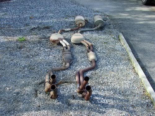

Took a complete exhaust off a 1992 190e 2.0 (mine is a 1993 190e 2.0). As you can see in the pic the '92 on the left has a lambda sensor and mine does not, now I am convinced that my car has fuel injection....
Any body have a theory? Is it ok to use this exhaust as mine is ROTTEN. The other differences are that the 'new' one is stainless for the front half and the cat is bigger.

its only the 190's with Cats that have Lambda's.

If yours is an "E" then it definatly does have fuel injection.
The German word For injection starts with an E
The exhaust on the let definaly has a cat hence the Lamba sensor.
Yours (right one) doesnt have a cat thats a small silenser box.
Will it fit, probably, will it work?
I`m not sure, someone else will be able to give you a decent answer later.

You will be okay using the exhaust with the cat in ,just do away with the lambada bit,its a shame you cant change the cat for the original box ,second hand cats go for forty quid. something to do with the precious metal coating the inside of the exhaust.

Sorry I dont understand that,the actual cat is a exhaust with a [cant think of the bloody name]but it is coated with this stuff,that attracts the exhaust molocules ,and tells the lamada sensor to enrich or decrease the amount of fuel,through the ecu,the cat box and the ordinary box are just straight through boxes, so if a ordinary box was fitted to a cat system it might cause problems,
But a lot of people have de cated their cars to avoid the expence of a cat.
does this make sense or should I go to bed, :blink: :blink:

Cars registered after Aug 1992 had cat. fitted + oxyjen sensor, also 190e cars ie. with fuel injection also have oxyjen sensors even registered before 1992.

My merc 190 E from -93, also has got a sond, but the lambda sond is fitted closer to the engine, so it should still be on the car. Try to have a look at the header if it´s there....
At least mine is there, and in that case you just need to plug the hole for the lambda and install the better exhaust and go ridin´ :driver:
Isn´t that first box on both exhausts the cat? Correct me if I´m wrong people, I´m not sure about this......
Good luck and tell us how you´re getting along with the upgrade.
Sometimes I should be doing the same, but for now i´m just trying to repair my old system B) We´ll see how long it lasts :unsure:

Think i have it figured. Emission control regs did not come into effect here until some time in 1993, mine was first registered in Carlow Feb 1993, the car that I took the exhaust off was possibly a UK import.
Tomorrow is a bank holiday so I will give the exhaust a trial run and have the mixture checked on tueday morning, if it is no good I'll give MB a buzz about a new one...

Well this lunch time i fitted the exhaust (cat and all) and all is well. it has a slightly different sound and the resonance aat 2k rpm has gone. I haven't noticed a drop in power yet it feels more responsive. Ill put that down to the fact that this exhaust has NO leaks, perhaps if I used an exhaust with no cat i would feel apower gain.
