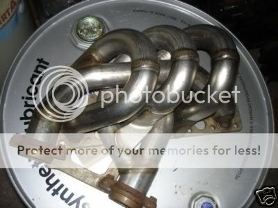

Hey,
I can buy a hedder and the guy tells me it is a dtm hedder.
So can somebody tell me if this is really a dtm hedder because it look to me it is a stock RHD hedder.
I asked him about the dimensions but i did not had a reply yet.
greetings Dennis

Standard 16v manifold.

Yes im certain its a standard 16v manifold, same as below:

here you go
RHD hedder
It HAS to be possible to modify one of those to fit an 8v right?! I had my head in my engine today and its seriously looks like the only way to pass that damn steering box..

I think it might be a standard 16v one. I don't have vernier at home, but I'm sure the pipes on my Evo 1 are a bigger diameter. :unsure:
Edited by Michael, Tue Sep 23, 2008 8:46 pm.
From another angle, but the ebay one does look different.
Thats because your Evo one is a LHD Michael.

if thats new where was it kept..........in the rain?
Tue Sep 23, 2008 9:40 pm
The barrel of Mobil1 that it's sitting on, would cost a € or two. :lol:

just got a mail from the seller:
the oval port is about 51x30 mm the 4 tubes are 45 mm outside diameter, the two round port are 52 mm when it is a standard hedder then maybe one which did not pass the quality control i found it in a garden of a friend and the ants lived inside, i asked him what it is and he told me it is from Zeuna Augsburg from the mercedes dtm time, they had to work all day long to make many different styles of hedders and often mercedes cancelled their orders because they found better solutions during testing... and this hedder should be one of the cancelled ones... regards andreas

there were no rhd 190 DTM cars

I dont think thats a DTM exhaust mate! Zeuna did make different styles of manifolds but i dont think thats a DTM one..
this is a pic of a 2.5-16 / evo i manifold that i have here sitting in the garage and the measurements are bigger...outside diameter of the manifold pipes are 50mm and this manifold does look a little bit tidier with less runs of pipe.

and this is a pic of a works DTM exhaust

the principle problem is that dtm manifolds are LHD where as this one is a RHD
were any genuine MB projects DTM wise done in RHD?

nope!!!! they coudnt even be bothered to makes evos in RHD....LOL

Correct - there were never any RHD Evo's made.
