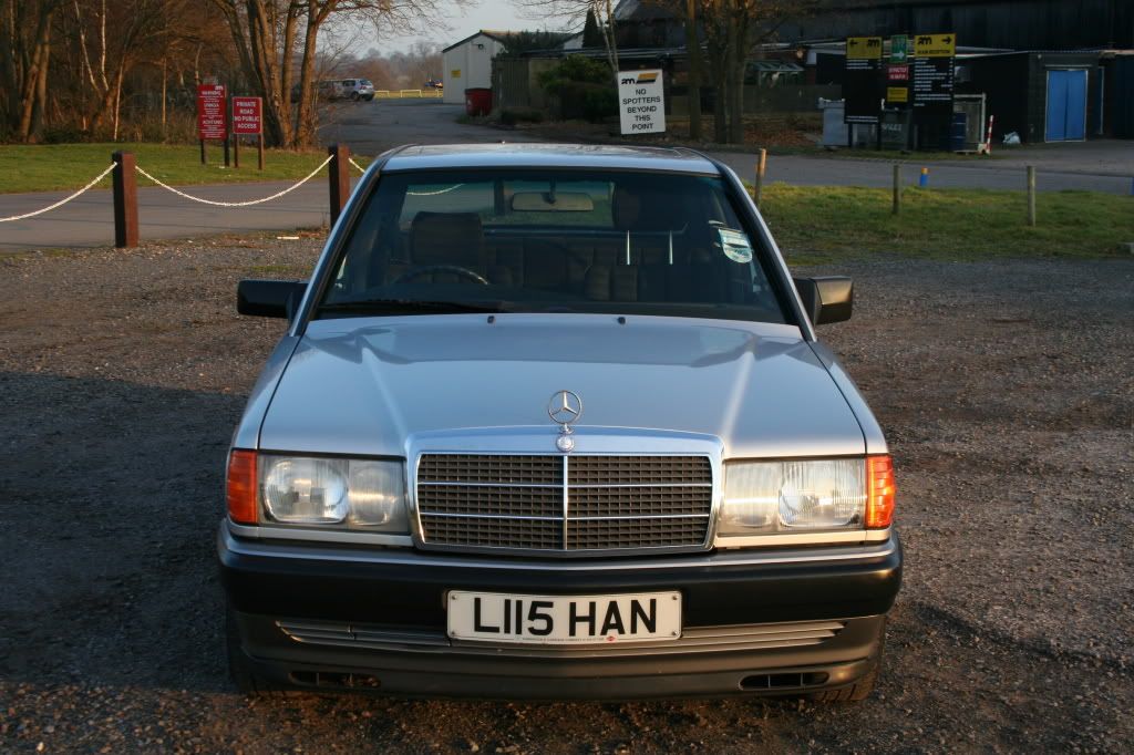

Dear Sirs, I have a 2.0 and have been wanting to do a front chin spoiler like this: ![]() Have done a bit of searching and as you guys said, it's the "Renault Laguna Splitter". But which model year of the Laguna? How about installation? Direct bolt on? I'd appreciate your knowledge and input. Thank you. Chris |

+1.. Lip. And IMHO the one with no holes looks better. Whats the ride height of the car its going on like? |

That looks like Steve's old 2.6, with photoshopped headlights. |
| kentronix | Thu Feb 12, 2009 4:12 pm Post #8 |
his barn and gravel too !! |
| bri957 | Thu Feb 12, 2009 4:17 pm Post #9 |
That's what gave it away. I'd love such an cool garage. |

yep my old car but my current garage splitter cost me a fiver from the breakers and i have always just screwed them on (ok wind redirecting unit)my old one pictured without the holes is a bit harder to find also they are just stapled to the renaults and can be pulled off (but only from cars in the breakers yards |
