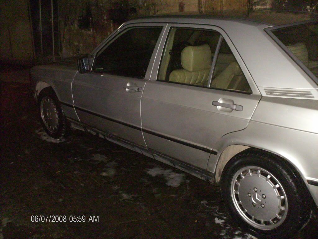

matth190
190 squirt
Have a look here, and see how bad they are:
I think they really need a spray. Or just with Auto Glym, and they are back to black? But I dunno..

christ, they look colour coded !!
matth190
190 squirt
Thu Apr 9, 2009 11:52 pm
:lol: seems like I have to respray them black with that answer!
