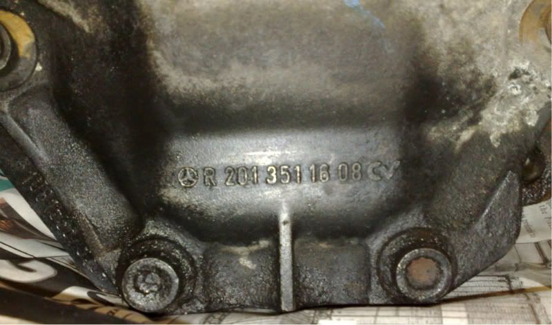

alogaparaloga
Today I had a look on the 202 diff to see what different to the 201 diff.
The first thing is that it has no vibration dampers as the 201 open diffs
second is that the mounting points on the backplate are different.
the 201 has 4 mounting holes while the 202 has 2 holes only of bigger size.
an example image that I found on 2phast.com
The following are from the w202
the diff housing serial number is 1081536 3.64
Now the plan is to get under the car and measure the lenght of diff, bolt patern of driveshafts and bolt patern of the back plate,
If the back plates are interchangeable and the total length of the diff is OK then it should go straight.
If this is the end of similarities then I ll have to source another 201 diff and sell the 202.
Edited by alogaparaloga, Sun Feb 6, 2011 1:34 am.

alogaparaloga
I just want to report back regarding this differential interchangability.
For the differential that I described in the posts above, which came from an auto C180 I had to swap the Cover plate and the input flange at the front.
No modifications were required for anything else. so for £80 quid of e-bay well worth the money.
As far as the flange to flange difference between the two (new used/and old diff) there is no need to machine anything as the half shafts can easily take a 2.5mm difference.
so the answer is yes they will change with little effort :)

alogaparaloga
Check this mate diff discussion thread
You have to consider two things Output Flange to flange dimension and short or long nose (small case as found on 8valve 190s or bigger one as found on 16V) for the packaging but the other basic feature is the ratio. You have to maintain the ratio to keep the speedo reading correct.
Salar
Salar Turk
alogaparaloga
Wed Feb 9, 2011 6:52 pm
Thanks mate for the advice, but how can the ration be known, as the only numbers I could find on the back case of the diff are the following: R 124 35 106 08. Also, I think ratios would differ from a manual 190 to an automatic one. So, any clue :help:
alogaparaloga
Back of the diff, position five o'clock there is a stamped number on the diff case. just next to the cover plate. you may have to rub off all that sticky dirt to see the number.
Of course ratios will differ from autos to manuals but the idea is that if you find a compatible diff from a much newer model like a C230 or C180 in my case.
I say that because you get a chance of getting something good for a very good price. ie my car is manual and 18 years old but the replacement diff comes from an auto that has less miles than my car, it is less 4 years of life but most importantly an Auto diff has much smoother life than a manual. So it's less likely to be knackered.
I am afraid you have to do your own research on that or bite the bullet and get your diff repaired.
