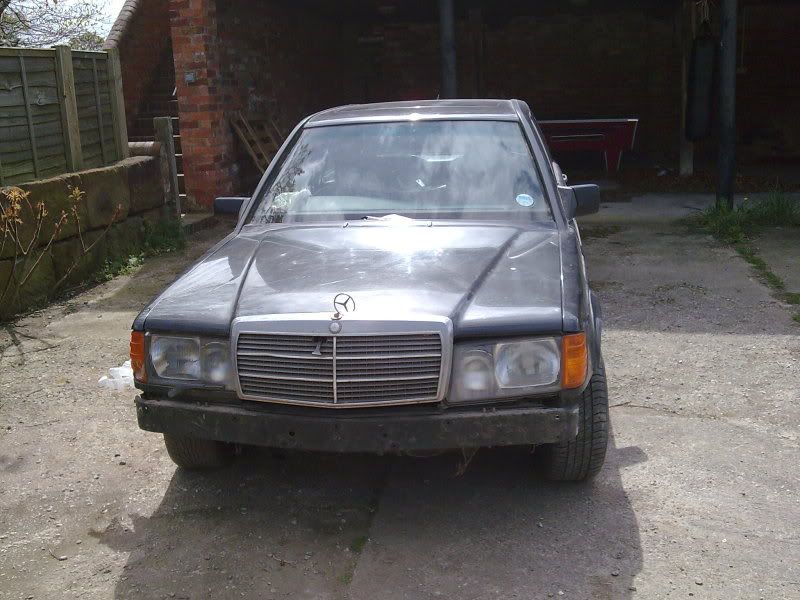

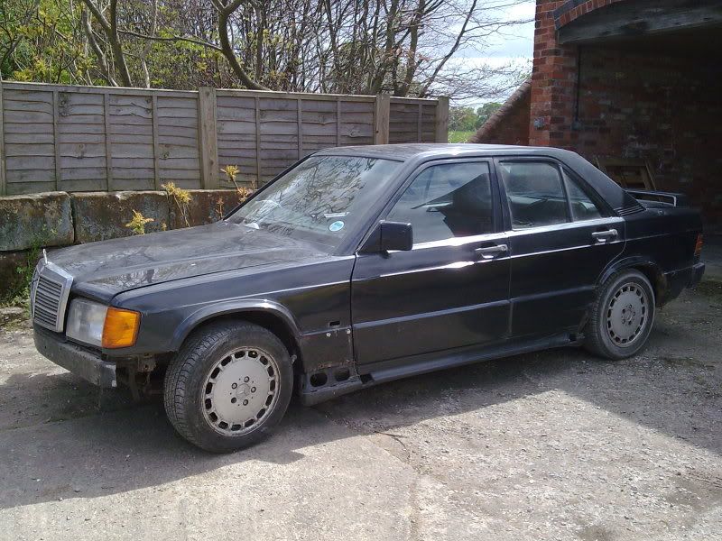

Well Now I've finally got some space, time and a tiny bit of money spare, then I have pulled the cossie out of the unit and had a good look at it.
Bear in mind it had some accident damage and it was never a minter anyway.
The mechanical repairs don't bother me at all, but I want to know if you think it's worth repairing the body. I don't have loads of cash but am fully prepared to make this a long project. It's been off the road for around 5 years and over 3 were spent outside in all weathers with no protection.
The bumper/spoiler is pretty much ok, though off the car, same with rear valance.
Both rear arches are shot, really needs inner and outer ones, also just in front of arch on floor is a hole both sides, but good solid metal pretty close, though hole is large.
Then under the floor just after front arches are two other holes, one each side.
Then last real bit of rust is under the passenger side front inner wing, just by strut top.
Both front wings will probably have to be replaced, doors are pretty good, sills seem to be solid through the gaps in kit, so not expecting a lot of damage under them
So mainly we are talking rear quarter panels (£500 the pair from merc, 16v ones), inner arches though could repair but better to replace. Decent patches over the 4 holes front and rear on floorplan, then repair strut top on passenger side front. Then sort minor dents, scratches and respray.
Like I say the mechanical repairs are fine, engine is good, most other things would probably need replacing in an old one anyway.
In a few months I will have around a grand to spend on a car, that should pay for arches and some body repairs, if not all, depending if I can get a friend to help with them.
Anyway what do you lot think, is it worth it, I've never had lots of cash but I've always loved mercs and feel in love with the 190 since I first drove it.
Mike

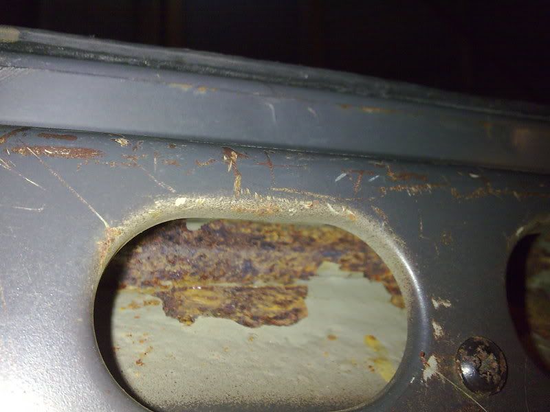

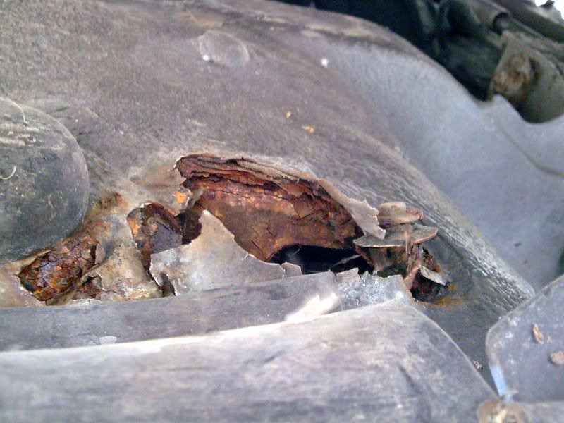

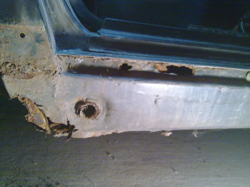

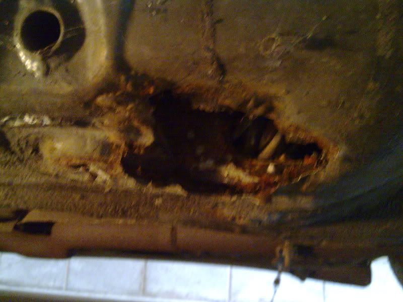

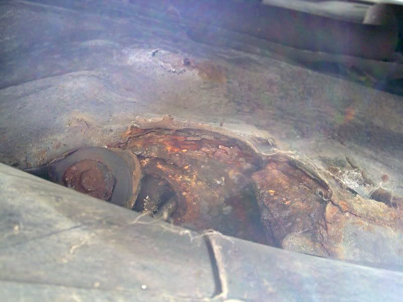

Took the skirts off and had a good look in the boot.
Front wing/sill. You can see the hole underneath, the wing is gone on this side. sill is solid apart from that hole under, though it isn't over good metal going under the car from that hole, not terrible but will need a bit more cutting out. Still it's the floorplan so not too hard to do.
Rear of sill, rear arches shot, but i knew that, same sort of hole as at the front. Pity the sill has gone up on the top edge, possible to repair but really for the money may as well have outer sill, at least I get a good look inside then.
Under rear screen, that's surface rust, nothing major there so well pleased with that part.
Bottom of boot lid, well knackered but the rest of the lid is fine, just down here hidden, so possibly a repair rather than a lid.
The bits shown are the bad bits, anything else is pretty solid. Checked the doors, they are in pretty good nick, boot floor is fine apart from round arches, none on roof.
All in all about what I thought, so still a possible repair on this car.
Mike
