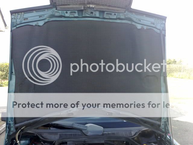

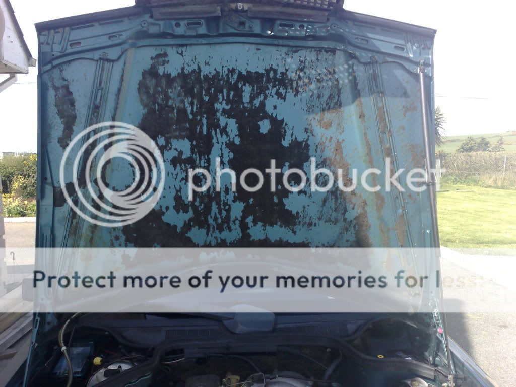

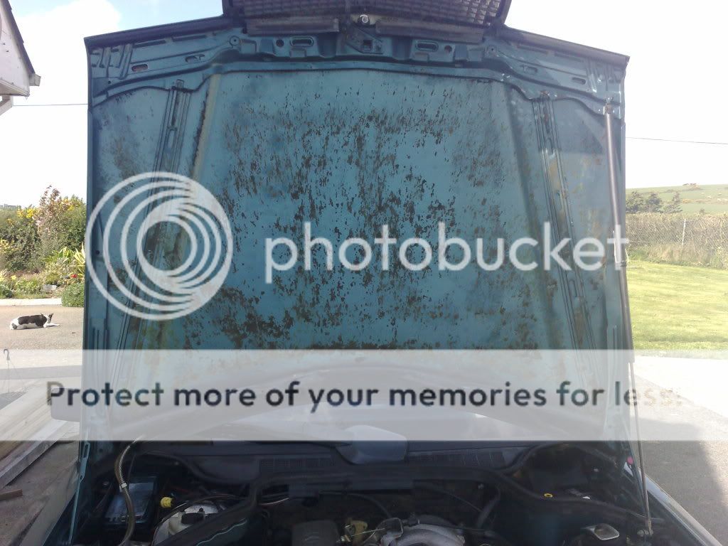

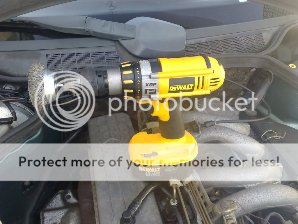

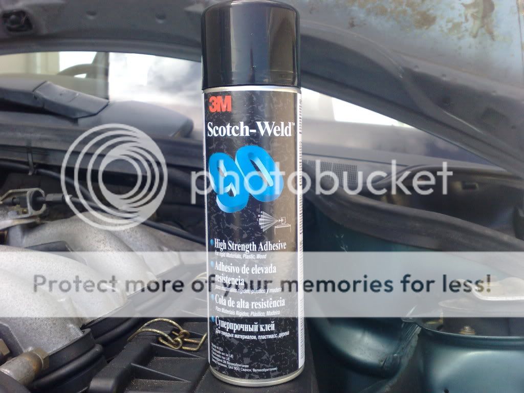

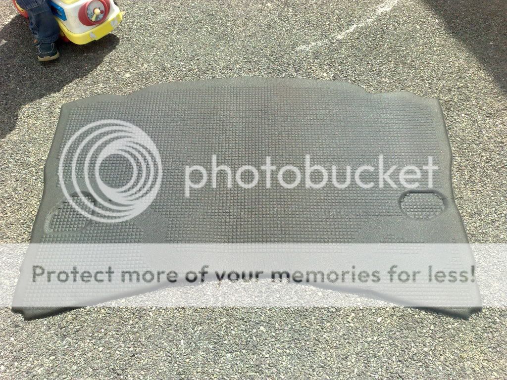

Thought this might be usefull. First You need to order one of these. Child and fast response fire truck not included. ![]() Part No. ![]() This is the bonnet after removing most of the sound proofing by hand ![]() I used a drill with wire brush on low speed setting to remove the rest ![]() This is what it looked like after wire brush and a quick run round with the hoover to pick up dust ![]() This is the glue I used to attach the soundproofing. Yes it says for rigid materials,plastic & wood. But it is also suitable for foams according to spec sheet. ![]() The job would be a lot easier with two people and the bonnet removed. But there was nobody arround on the day. So it was a solo job. Offer the sheet up to your bonnet so that you will see it is a snugg fit and needs to be positioned properly from the outset other wise it will be crooked. I started spraying from the bottom up. Sprayed about 12"s of the lower bonnet portion and attached the lower part of the sheet. You need to work fastish as the glue sets fairly quickly. But You can lift and reset sheet for a short time. Be sure the lower section is straight before continuing. Once happy the lower section is straight, I then worked up the bonnet in roughly 12" sections and attached the soudproofing untill finnished. ![]() Result and also keeps that oil burner abit quieter too. ![]() Hope this is of help Steve B |

rhysmangatmotorsport , bought it a the local dealer here in Cork, Turners cross motors. It does not come with glue. It was another board member Marv who put me on to the glue which I got from www.safetydirect.ie. So all in it has cost about €90. Not too bad |

need to use high temp glue tbh anything else will melt. what temp as that spray glue useable too? only seen the high temp stuff in metal pots (quite think) |
| Avantdi | Sun May 3, 2009 7:02 pm Post #11 |
Fastest ship in the Galaxy
Temperature good to about 90c. That should be plenty.Have yet to feel a bonnet that hot on a road car unless it was on fire. |
| cossie connoisseur | Sun May 3, 2009 7:36 pm Post #12 |
cool, that should be fine. anyway its not direct heat but radiation that is the problem |

Just a quick update on how the glue is holding out. 3 week in and and it has not shown any problems, alot of traffic driving so plenty of heat generated, The glue is good, so I can recomend it. |

This is how the 2.6 looks like when installed.

Can anyone recommend some glue that is obtainable from Homebase , coz when I went to pack my bonnet pad & glue , I remembered I gave the M-B glue to another member . The Scotch 90 that is in the above thread is unobtainable near me . Jeremy |
| kentronix | Fri Mar 11, 2011 9:58 pm Post #36 |
I used timebond on mine, the tin. It was after reading lots of threads of people recommending it (not specifically merc). Its been on a few years and hasnt fallen off yet. You can get it in homebase, b&q and I think halfords. I bought a 500ml tin and I used exactly 1 tin. Homebase seems to only sell the 1L although you may find they have the smaller tin if you buy in store. |
