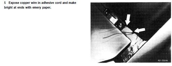

if it is the original windscreen ,fitted by mercedes.................it can be re-sealed .if you remove the bottom trim of the windscreen,right above the battery you will see 2 exposed wires![]() connect them to a 12v supply,let it heat up..............then when heated up ,apply a little pressure to the side thats leaking,disconnect it,keep the pressure on as it cools down.............and that should re-seal it ![]() ![]() |

Unfortunately no wires. Looks like the original seal must have been replaced at some stage. Any other ideas gratefully received |
