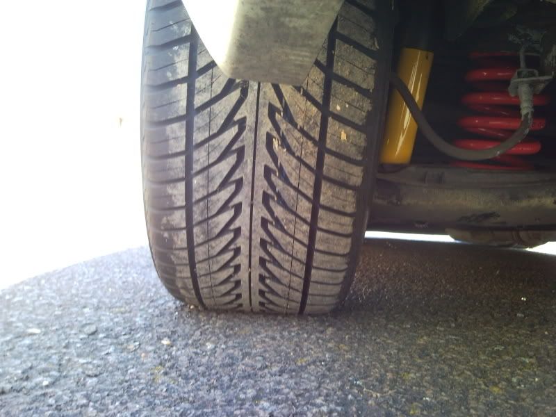

Japanese Import
thanks, just to give you an idea of what the rears are like here is some pics![]()
| bri957 | Sat May 23, 2009 10:37 am Post #4 |
I'm not sure how much of that can be diallled out with the standard eccentric bolts used in the wishbones. Wheels in motion have a very good reputation, and did a good job on a friends MX5. Slightly more expensive though. |

There is limited front camber adjustment and no rear camber adjustment. On the front once the factory camber adjustment limit is reached the solution becomes adjustable camber plates. On the rear there are some eccentric bolt arrangements that may work but the only true way to adjust the rear camber is to fit adjustable upper camber arms or non-adjustable shortened lower control arms. --Do a search on the 190rev site for camber adjustment solutions. It has been discussed to death. RDMTEK in the USA is a source of pricey but absolutely the best camber solution for the front and rear of a 201 or 124. --Google RDMTEK and read up on whats available: here is one of their websites: http://www.rdmtek.com/Shock_Towers.html bobf Edited by matsalleh76, Sun Nov 15, 2009 7:41 am.
