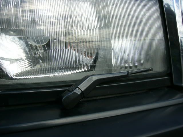

| Marv | Tue Oct 6, 2009 9:35 pm Post #8 |
I got it the part number it is A2018200245 priced at £6.42 and remember to get two. They look nice when there new, ![]()
