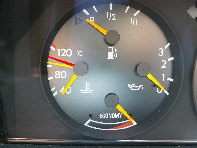

A picture always helps. On 3 of my cars the fan kicks in just above the first white line immediately above the 80. On the valver using a switch rated at 100 the fan kicks in at a point slightly more than halfway between the two white lines above the 80 which I would calculate to be about 110. in normal driving it sits just above the 80 where it should.
I know nothing but i would be a little concern at 110.

The valver cuts in just over half way between the 100 and the 120 lines

So thats about 112-115 thats high Andy, in saying that i dont own a 16v so best to take advice from those that do.
I'm very sorry, Andy. I totally misread your post, my mistake mate. That certainly way too hot!!!!!
I'd recommend you get a switch from the dealers using your VIN to make sure you get the exact one for your car.
The GSF and ECP ones can often be crap quality.
Once again, sorry for my misunderstanding.
No problems mate. I was sure it was too hot. Had already planned to give the stealership a call. What threw me was the new switch working at same temp as old one. Thought it might be a fault temp sender but that works ok around the 80 degrees . I'll get both just so I can eliminate those two things.
Andy i hate to tell you but there is dust in the bottom corner of your dash lmao lmao lmao
And the fuel economy is bad, you have no oil pressure, no petrol and cold coolant...best get it checked out :)
:lol: :lol: :lol: :lol:
Ukmerctechie
Hi Andy
If i am reading your post right your fan is kicking in at the red line on the picture?If so it is too high.
It should kick in at the yellow line.(admire the artwork lads :P :lol: )
Give me bell on Monday and i will go thru checking the system with you.
Cheers Andy

Yep Andy. It cuts in at the red line. The switch is rated at 100 degrees. The one I took out was genuine part. The one I put in from GSF; but both cut the fan in at the same place. I know the fan cuts in which people seem to think is fine, but it does not seem right. Given the summer traffic down here the fan gets a lot of use. If the car is regularly running say 5 degrees hotter than it should I would like to know why and see what I can do about it. I would guess it cannot be good long term to run hot on a regular basis.
