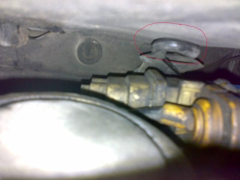

My idle is to low and not steady, after starting the engine for 20 sec its about 900 rpm, after that its sometimes 500-600 or 400-500 this is to low, the engine starts to shake. Today when this is happened I pused down the gas pedal i rev it up tu 3000 rpm I took of my feet of the pedal, the rpm-s wery slowly started to go back and stuck at obout 2000-2500 rpm. I have too shut down the engine and start it again, then its again ok. This is happening to me all day. What is the problem?????
3 days ago I changed the idle control valve ( its not a new one but my friend said that it worked ). I had to change it becouse my old one wasnt working at all.
And the last one, today I noticed a hose under the air filter, what is it for, the other and of it is loose/disconnected?
Here is the pic of it.
Please help.
Any sugestions are welcome

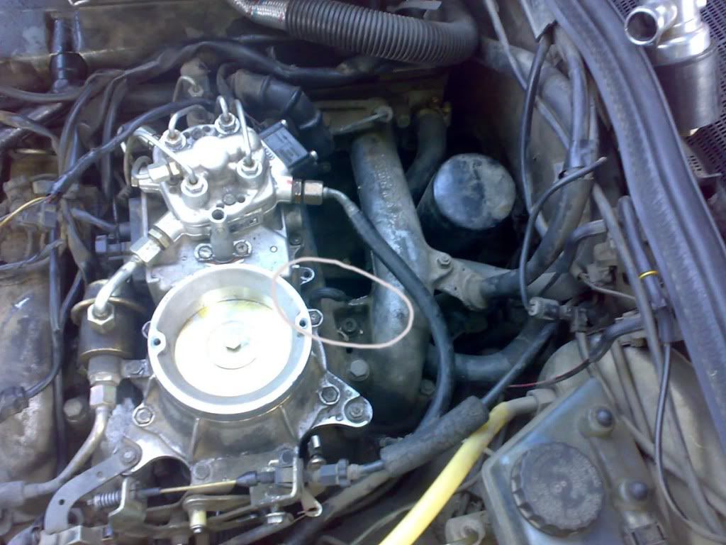

OK , I understand that the 1.8 doesnt have the Idle Adjust screw?
You could try adjusting the Fuel air mix so it runs a little richer, you can do this with a 4mm allen key through that pokey up bit above the afm plate in the picture (technical term) , insert and press and turn clockwise to thicken the mix (about 2mm) but please WAIT untill somone else with a 1.8 answers as they may know a better way, as I fiddled with mine and cocked it right up so do this as a last resort

isnt the long upright hollow metal thing with 2 screws above the air intake in the picture the air intake adjustment? (Allen key hole inside it)
messing with that in my 2.3 16v fixed my idle problem ... i think :S
again wait for smoeone with more aof a clue than me to reply before you kill your car going off my (lack of) knwoledge

They told me that ist where I can adjust the mix of an air and fuel/lpg.
I`ll wait for more replys
Nobody knows the purpos of the tube ??? The other end is loose/cut of, so I`m a lite bit worried, wat is it for
Yes that is the Air Fuel mix adjuster, turning it up a bit should stop the idle problems, (2mm clockwise)

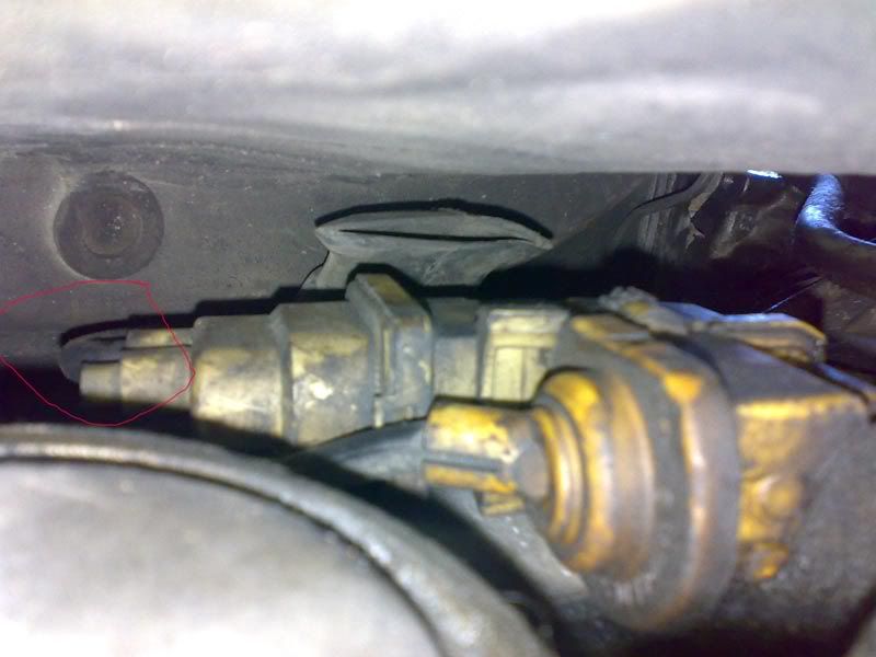

The pipe is about 0.5 m long and the other end of it was laying somewere next to the gearbox
It looks like a vacume tube so that is why I`m a litle bit woried, OH and a few minutes ago when I started the engine a hear a loud voice from the
transmition its like when a bearing is gone. I dont know is this has to do someting with a this tube????

if im correct theres a plastic pipe on the side of the gearbox shaped like a y, the hose from the manifold connects to it, its a vacuum line.

If the tube is a vacuum hose then that is your tick-over problem, you will have to either wait untill someone tells you where the other end goes or you will have to get underneath and find where it belongs, under no circumstances play around with adjustments, that can be fatal to your engine.
If you have running problems it will be to 99% something else as adjustment screws don't usually turn themselves.

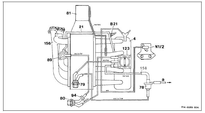

Are there any diagrams/drawings/pictures of these vacume pipe lines for mercedes??

No luck so far, the problem is I cant get undernet the car. I do not have a garage for these kind of repairs.
But I found in the manual the pipe, bu it not saying anything about it :-/
Edited by Bre, Mon Jul 27, 2009 1:48 pm.
balamb37
I don't think the pipe we are talking about is on that diagram, as that diagram shows all the connections to the 'Temperature sensors and switches' on the engine itself. you need to find the one underneath your car connecting to your gearbox.

I`m back. I spent more than 2 ours undernet the car, 50% of the job is done. :'(
I just cold not fine where that pipe goes.
But I found another pipe witch was disconected
I fixed it I hope thats its original place :lol:
Can somewone tel me undernet that pipe that i puted back, is there going another pipe or noth???
Does enywone have a picture ore conection diagram for it. This device is on an automatic transmision
Oj yes almost forgat the idle problem solved.
