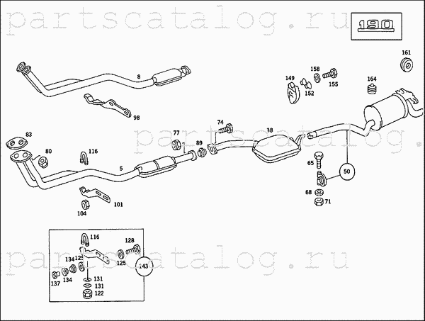

| stwat | Fri Aug 28, 2009 10:18 pm Post #6 |
I don't know what engine your car has moobarr but the exhaust systems generally all look like this.![]() The back box section joins at the middle box, not directly behind the back box. |
| big al merc | Fri Aug 28, 2009 11:12 pm Post #7 |
nice one stwat i thought it was a bit further back on the car but then i haven't seen a standard exhaust for a long time on my car

Bitchin
The original system the car came with is a one piece one. The replaement backbox is a separate piece,the old box is cut of at the pipe behind the centre box and the new one clamped on over the end of the pipe. All the 190's were like this when new,goes to show how good the original parts were,20yrs and only just failing. |
