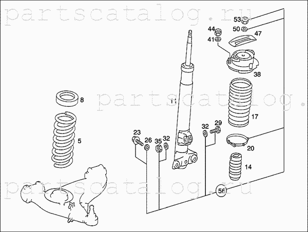

These are some part numbers from the russian site.
A2013204430 DAMPER STRUT DAMPER STRUT
A2013203430 SHOCK ABSORBER SHOCK ABSORBER
I don't know if they will help at all.

You can add them to basket on the mercedes parts website so I guess they're in stock?
http://www.mercedes-benz-parts.co.uk/index.php?option=com_virtuemart&sku=a2013204430+&Search=Go&page=shop.product_details&flypage=shop.flypage&option=com_virtuemart
Not as much as I thought they would be either!
Tim
This is for the Shock Absorber
LINK
£120.06 So more than the Damper Strut £85.45. I take it the damper is just an insert? And the Shock absorber the whole unit? ^o)
