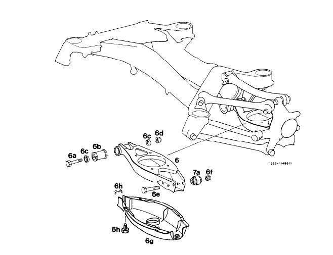

Hi! My car failed an MOT recently because of one of the rear lower arm bushes, the outer one, was too worn. Well, I didnīt think it would be much of a hazzle to fix, so I bought the parts and gave it a go. But my job stops pretty quickly, since I donīt even get the center bolt off. Iīve cracked my tools on this, but still no luck! Has someone done this successfully? Do I have to get the center bolt off or can you change the bushing with the parts on the car? |
| Richy190E | Sat Oct 3, 2009 3:37 pm Post #2 |
Which bush are you talking about mate? The outer one on the rear lower arm is part of the hub rather than the rear lower arm. Its a sperical joint and requires either a hand press to do the job on the car or remove the hub and a flypress to remove it. Edited by Richy190E, Sat Oct 3, 2009 3:39 pm.
| highwayman | Sat Oct 3, 2009 3:48 pm Post #3 |
Polar bear
Itīs the outer one Iīm struggling with. If it had been on the rear arm it hadnīt been any problem at all, but since it sits on the hub it seems to be pretty complicated. Iīve tried to remove the whole hub, but it seems to be cursed cause it wonīt come loose no matter what I do. Are those hand- press tools available to buy or do I have to get a professional to do it? |
| Richy190E | Sat Oct 3, 2009 4:10 pm Post #4 |
To do the job yourself you may be able to make a small puller. You'll need: A bolt (Long enough to pass through the joint and your socket) Nuts and washers for the above bolt A socket big enough for the joint to fit inside, yet small enough to rest on the shoulder of the hub. you'll need to disconnect the shock absorber, ARB droplink, hub end and lower the arm downwards. Set up the home made puller and extract the joint. push the bolt through a couple of the washers, then push them through the joint you want to remove, fit the socket on the other side of the joint with the open end facing the old joint. with the bolt threads protruding through the socket drive hole fit some more washers and finally a nut. tighten the nut and bolt and this should extract the joint. To refit use a large thick washer(s) on the outside of the hub, pass the bolt through, through the joint and through a socket big enough to rest on the shoulder of the new joint. tighten until the bush is home. No need to remove the hub really, although if it sounds too much for you its best not attempted. |
| shrekky | Sat Oct 3, 2009 4:16 pm Post #5 |
![]() 7a in this picture ?..................... mine was an absolute b.i.t.c.h. to do,i ended up taking the hub off the car |

Yea, thatīs the one right there... Gotta check mine out and see if I can get that one sorted. Iīm a bit worried, as it seems to be pretty worn out that whole bush. I was actually thinking of the flypress solution myself, but as I didnīt get the hub out, I must be considering other options. How much can a professional charge me to change this bush? In case the whole car ends up in a pile of metal....
