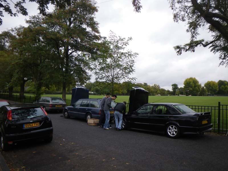

Unfortunately I didnt think to get the camera out until after eddie, adrian and andy (chap from a veg oil forum) left so just the 2 300tds and chris' 190d-2.5d.

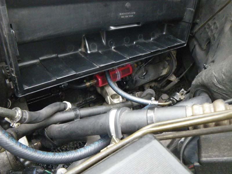

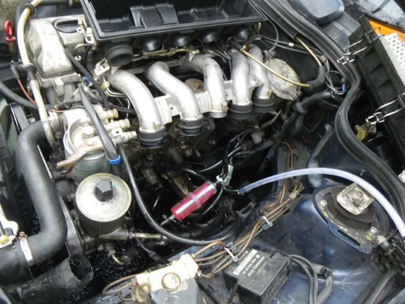

Chris fitting the oversized fuel filter (after the heat exchanged to help filtering when cold) and bypassing the fuel thermostat.
Nezamr doing the same. Such a tidy clean bay.
Hey look, for once my bonnet isnt open !!!

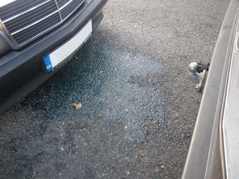

Anyway, its only water :P

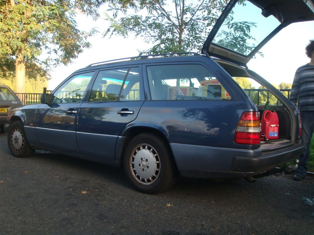

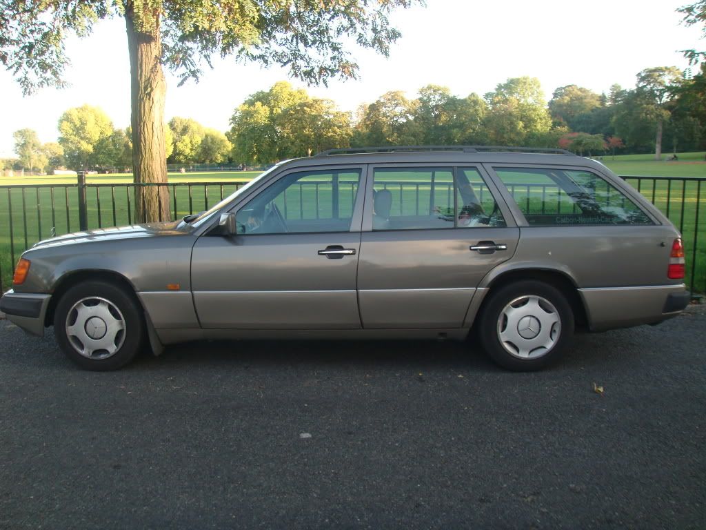

Two members of the Veggy gang Kenny left, Reza to the right and my car not looking like a vegetarian :P

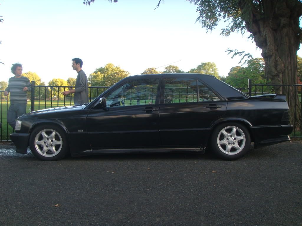

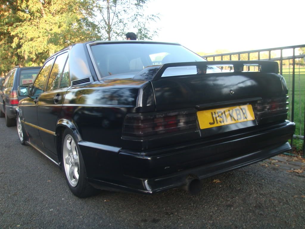

Reza's new toy :P ...nice ;)

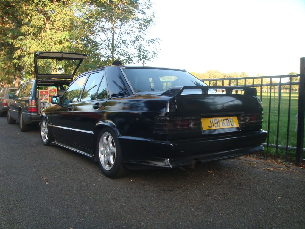

Kenny's heroic high miler ready as ever for its next 400k.

Gentlemen- What is the purpose of by-passing the fuel-thermostat
Edited by pwbadi, Mon Oct 12, 2009 8:58 am.
The input joint on the fuel thermostat is plastic and a very common point of failure. When we disconnected Nezamr's it was already failing. Plus, the fuel thermostat is there to stop sending the fuel via the heat exchanger when the fuel is above a certain temp. This temp is quite low as its designed for diesel. When on veg you always want to send the fuel to be warmed so its best to bypass the thermostat for this reason too. There is a tutorial on it somewhere in the alternative fuels section. Its REALLY simple.

Ken, what micron do you reckon those extra large filters are? The fact you can literally see the holes in it makes me think it's got to be pretty high i.e. 100 micron? I'd have thought the standard one would be more like 10 micron?
Standard inline filter is about 80-120 I thought ? Its only the canister filter thats particularly low. Despite what people say about the inline being there to avoid clogging of the canister, I am pretty sure its there to stop bits killing your lift pump.
EddieJT
Oh really? Ok, didn't realise the standard inline filter was so course.
If that's the case then I agree with you.
