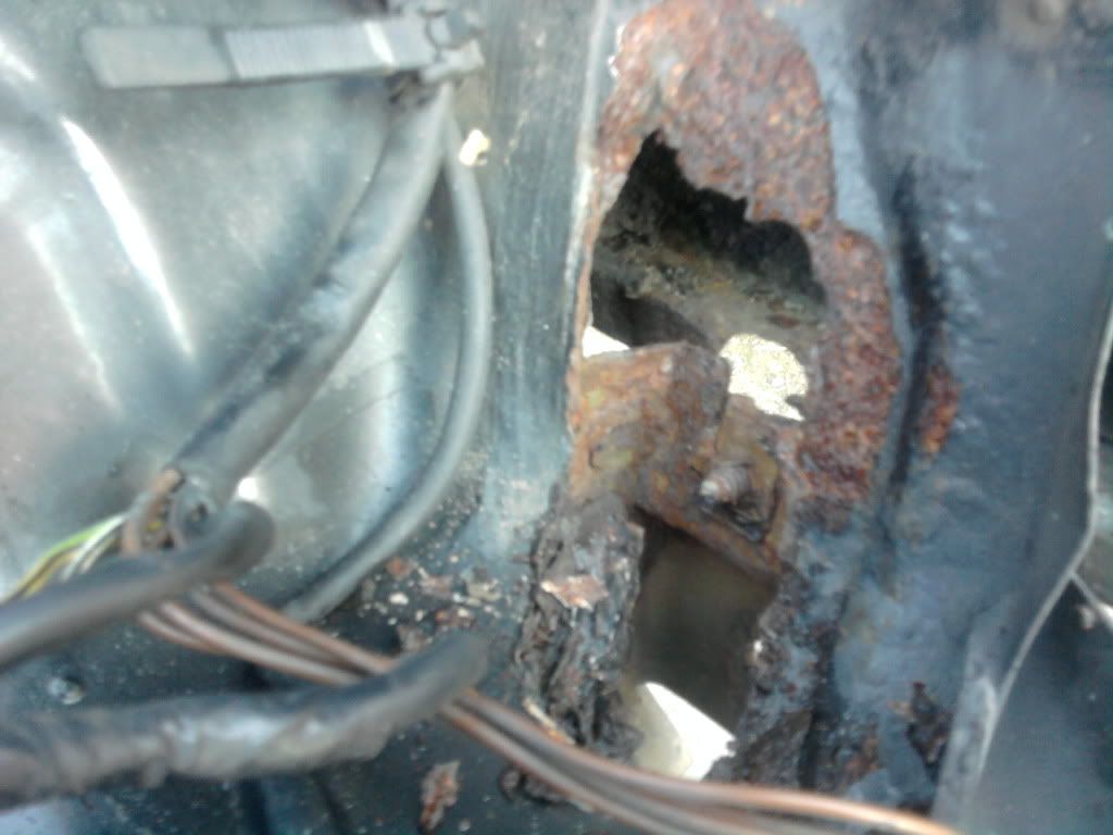

Heres a vid of the findings
It showed very bad corrosion to the inner wing,outer wing mounting brkt,headlamp bowls.
The wing was removed only to find more botched work.
The headlamp bowl on the NS had been poorly repaired and attached,and some rot to the battery tray area had worked its way in to the main front clip attachment area(Where it joins the Apost).
All the rot was cut away,a new slam panel was ordered and new metal welded in where needed.
The repairs needed were,new inner wing area fabbed and welded in,battery box area reapired,main A post seam reapired,small repairs to the headlamp bowls and a repair to the outer wing.

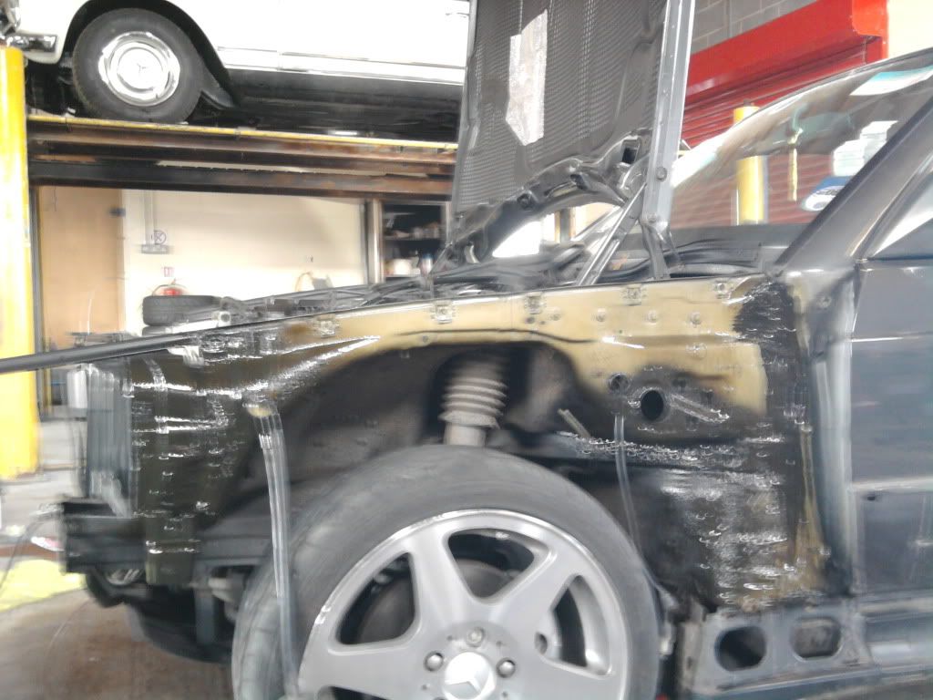

A before pic of the inner wing area.
After all repairs to the front wing area and A post/battery tray areas.

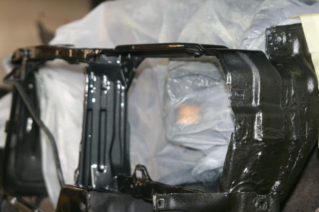

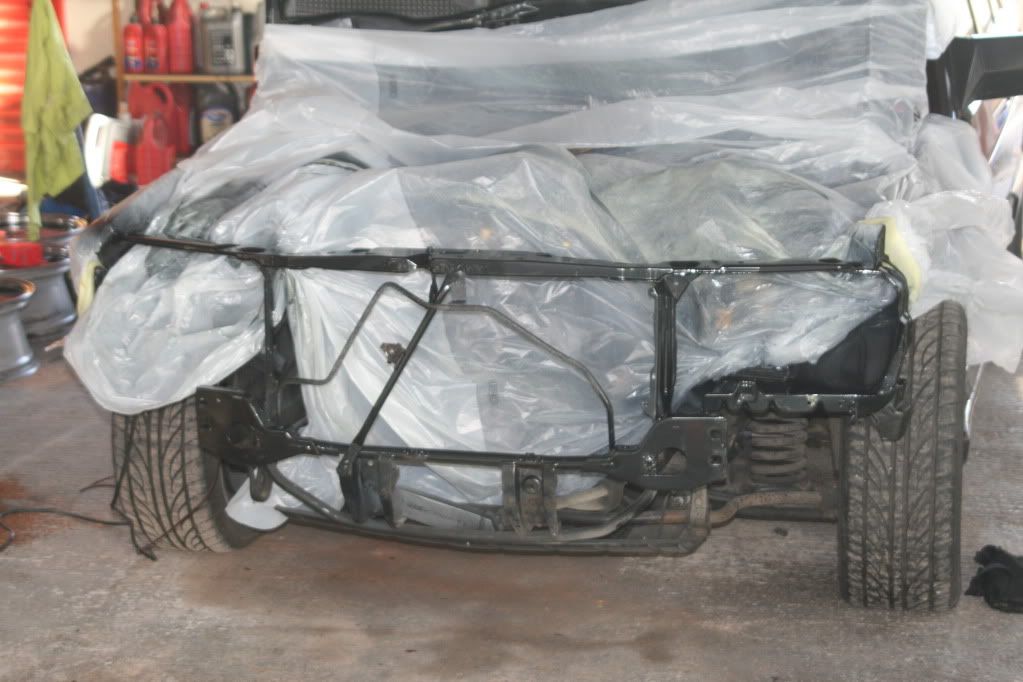

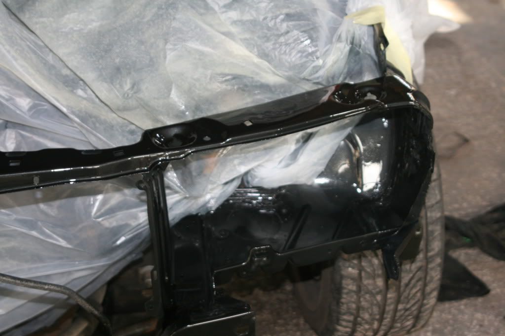

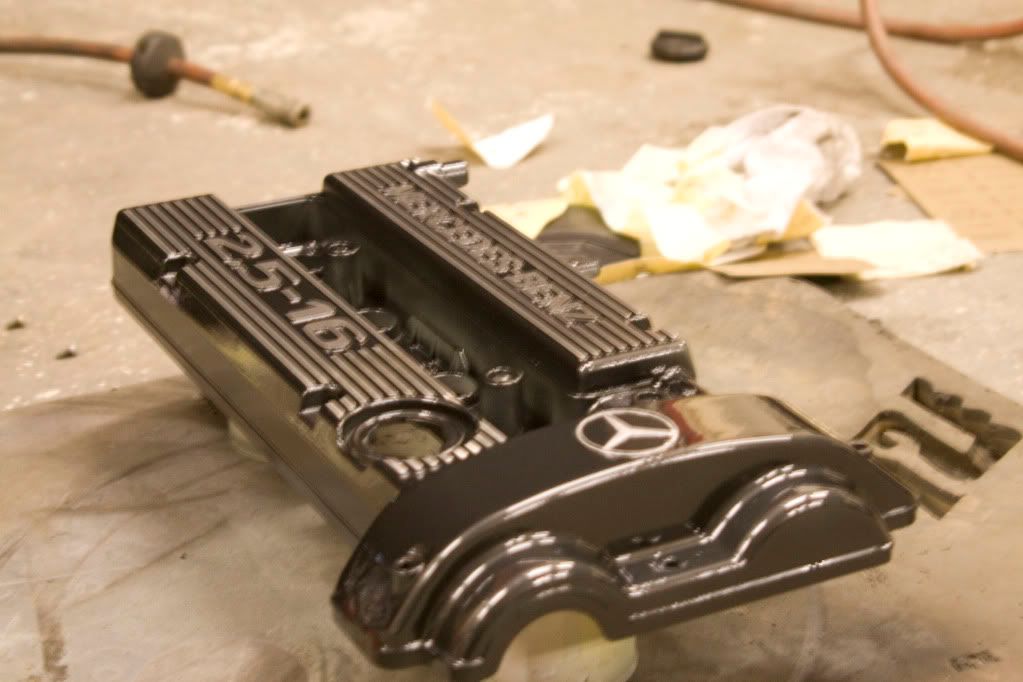

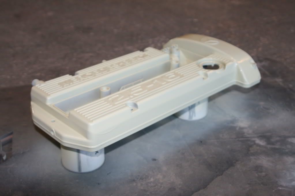

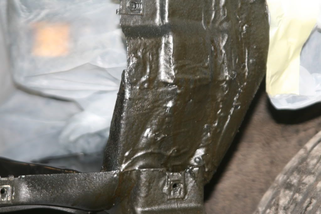

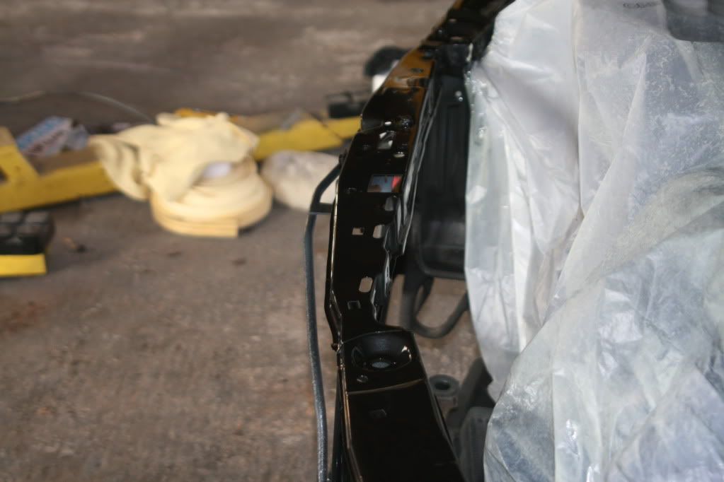

Todays jobs included...........
Painting the repaired areas and slam/headlamp bowls,wax caoting the repairs and inner underbonnet area.

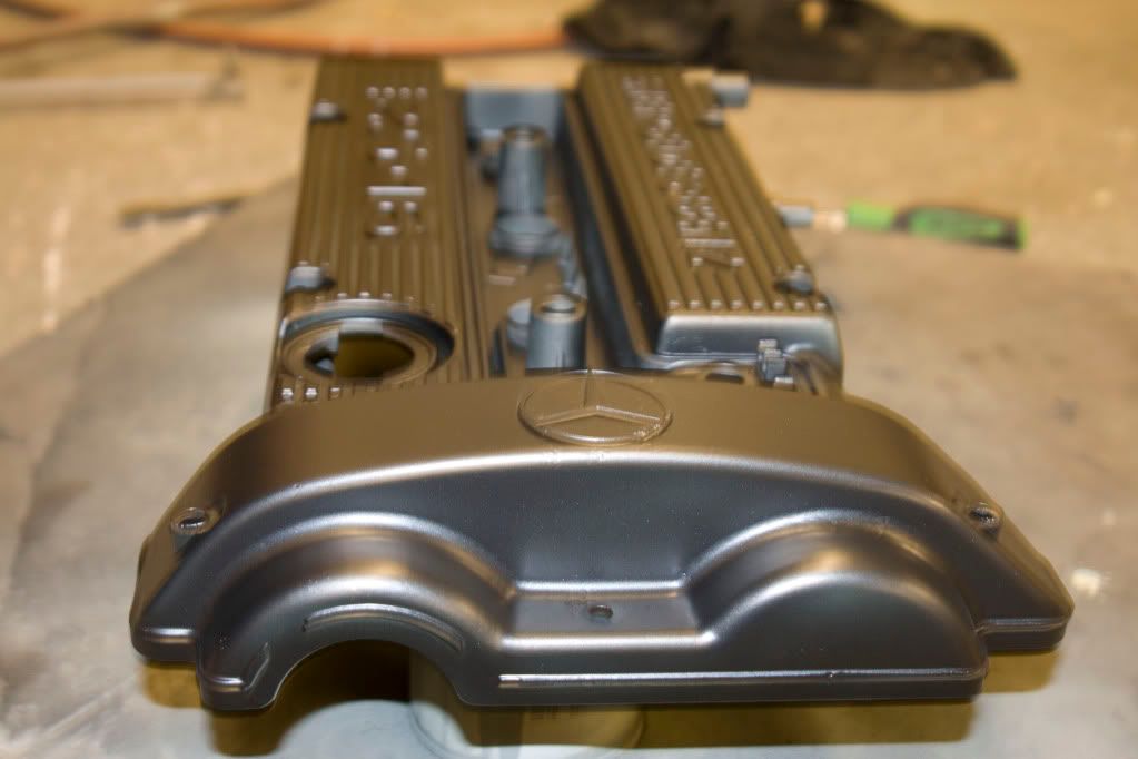

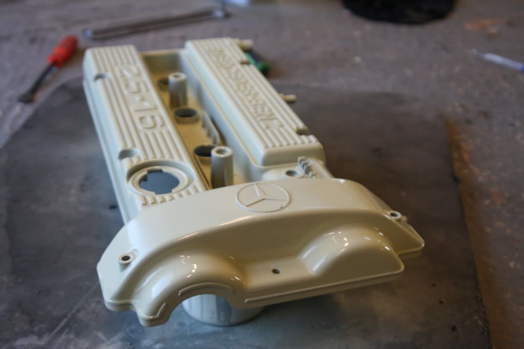

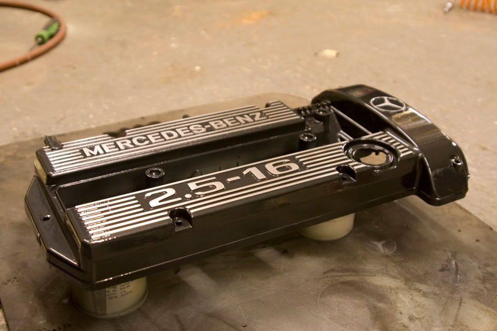

Fitting new ducting for the alternator wires,shotblasting the rocker cover and repainting it 199 and clearcoat.
Plus i sneaked in a shotblast and repaint of one of my Aero1 wheels LOL
Some pics..............
Painting underway
Waxing started

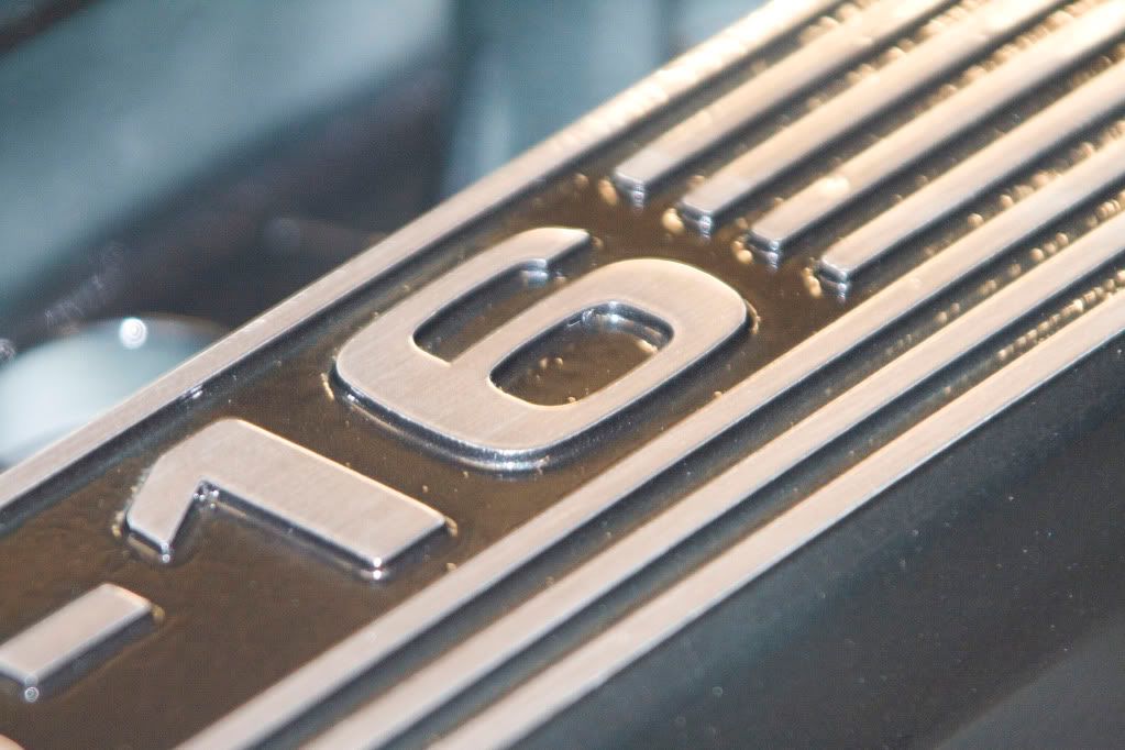

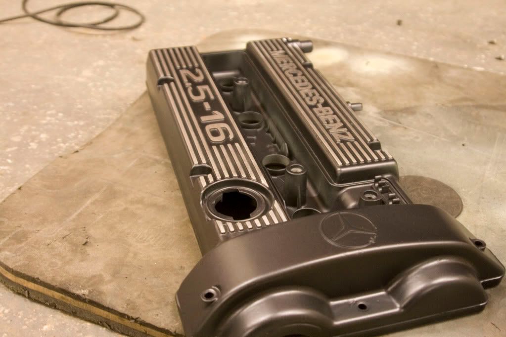

Onto the rocker box
Box in colour

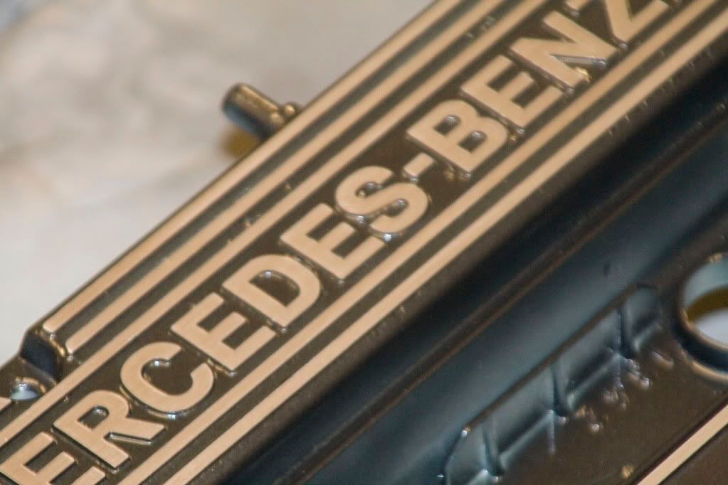

Revealing the lettering

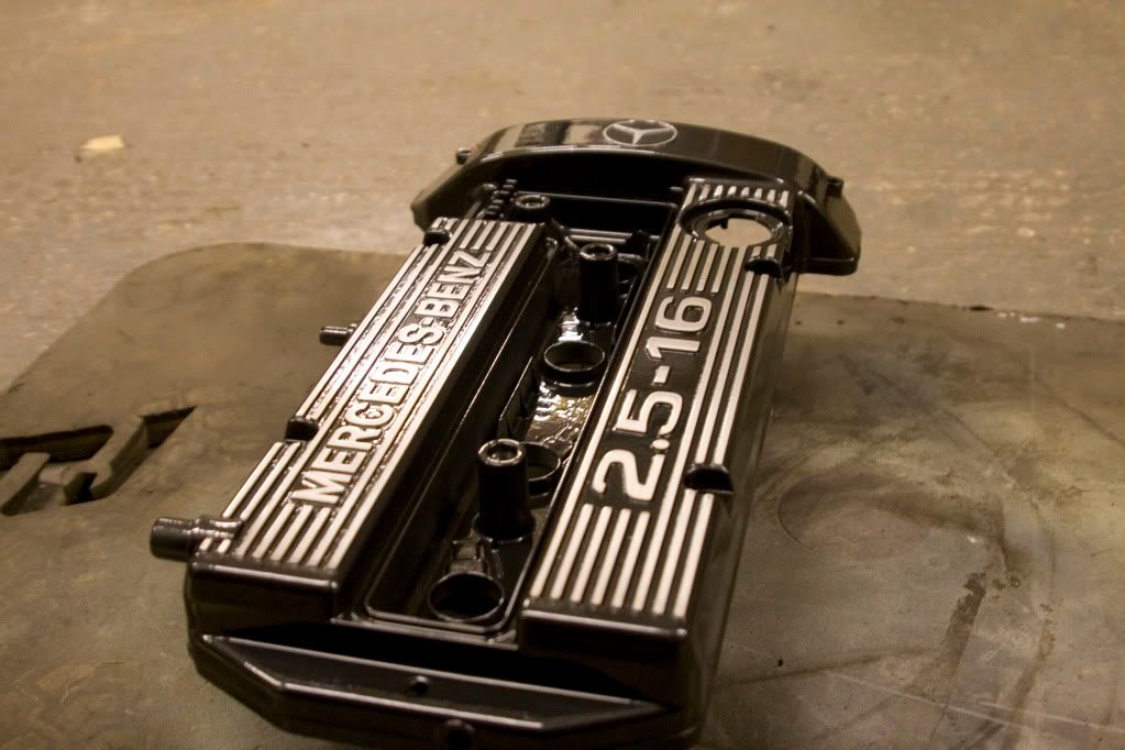

Final lacquer
Lettering closeup and final shots
New oil cap and rocker gasket arrive tommorrow and then fit onto engine.

smiffy
had to say that the detail on the rocker cover blew me away ufck me! B) no wonder your business goes from strength to strength andy.
