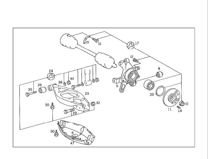

Hmmm, well its booked in to have a new strut on Tuesday and I've asked for the old one back so will see what's what. As I'm at uni atm I can't really look at it myself as I don't have any tools with me so I'm going to have to go with what they say I guess. From what I can tell it seems to be a fairly well respected specialist and the complex certainly impressed me so I've no reason to doubt their know how. Based on this diagram: ![]() Its the mounting in the bottom hole that has failed, which doesn't seem to be available as a separate part, unless anyone knows otherwise? Tim |

Number 8's the lower rose joint, nothing to do with the strut.
| Tim29 | Thu Nov 19, 2009 10:03 pm Post #18 |
Yes that is fine on mine. According to the specialist there is a rose joint within the strut mounting. It is this that has failed on my car. Tim |

On a W124 estate bush #8 can make a creaking noise when pulling away slowly. It's replaceable separately from the leg Nick Froome |
| Tim29 | Wed Nov 25, 2009 5:25 pm Post #21 |
Got the car back today, suspension is now completely silent! After contacting me they've replaced both the rear strut and bush number 8 as it fell apart when they dismantled the hub. I do wonder if the strut did need replacing but I don't really have anyway of knowing for sure. I've got the old strut back and its definitely pretty new, so I'd say it was new last December. Considering the work done I'd say the bill was reasonable at £345 all in. It was a different specialist to who I usually use and I probably would use them again if needed. Does go to show how the 16V really is in a completely different league to the 8V, to have both my rear shocks changed on the 8V came to under £100 including parts and labour! Tim |
