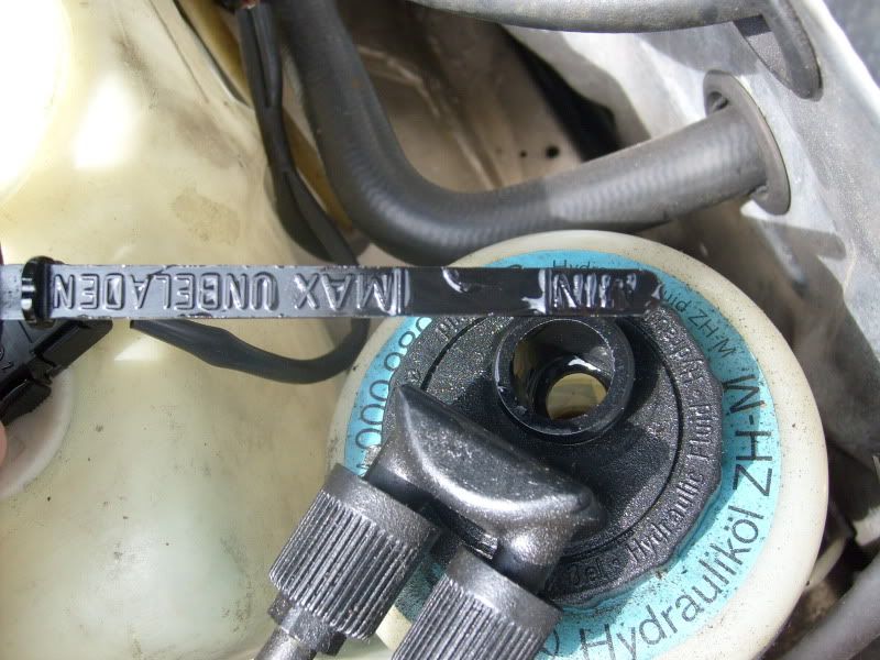

Hey....can anyone post a photo of the ideal fluid level for sls? Think mine is overfilled and presumably this will effect the ride height at the rear? Finally should I measure the fluid level on the dipstick with the car running or engine off? Thanks.....appreciate this topic has been covered to some extent but Im new to 'sls' hence all the obvious questions.
| stwat | Fri Jul 2, 2010 2:59 pm Post #6 |
Anywhere between the 'MIN' and 'MAX' marks on the dip stick is OK. It doesn't make any difference if the engine is running or not. The level always reads the same. On mine anyway. This is with the fluid filled to the 'MAX' on the dip stick. ![]() ![]() Edited by stwat, Fri Jul 2, 2010 3:12 pm.

Hey.... thanks a mill for early reply Mine is def overfilled must rectify same without delay. Cheers for the advice..........

No problem mate I forgot to mention, the ride hight will not be affected at all by having to much oil in the bottle. Also it won't be affected by having to little fluid.(below minimum) |
