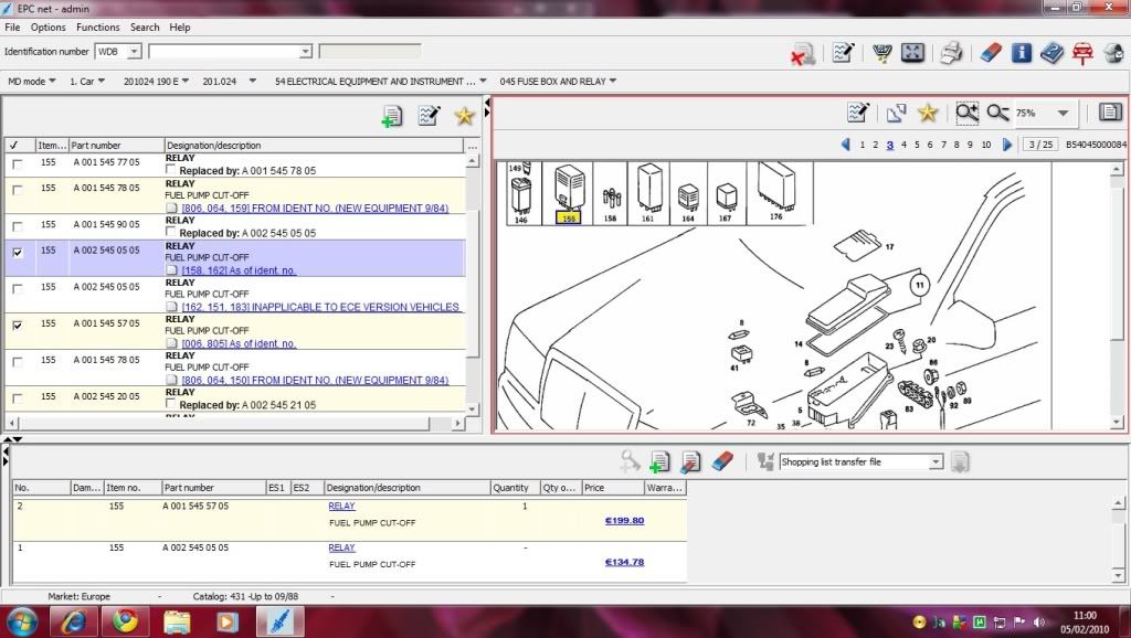

Have 1986 2ltr 190E auto. No AC or ABS. I need the correct number for the Fuel pump relay. The one l have is trashed no. 002 545 33 05 9 pin Anybody help. Regards Des |
| papa | Fri Feb 5, 2010 12:06 pm Post #2 |
With cat A 001 545 57 05 Without cat A 002 545 05 05 But I might be wrong in which case I stand corrected
| Desrob | Wed Feb 10, 2010 1:15 pm Post #3 |
Thanks, For the info. The one on the car has 9 pins, l understand the kickdown pin but hav'nt got a clue what the other 2 are for. it may not be the right relay for the car! Des Roberts |
