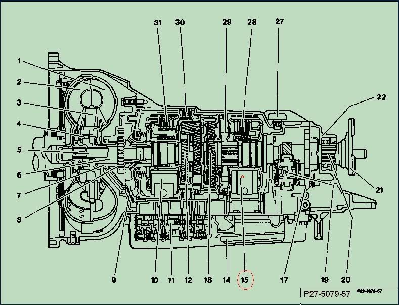

| Ukmerctechie | Thu Feb 11, 2010 3:31 am Post #14 |
The oil out of the top of the box is due to overfilling. The plug on the top of the box is a relief valve to vent off excess hot oil. The slipping is probably due to a worn clutch pack,or wornout convertor(unlikely as you say the other gears are fine) or tired teflon rings in the K2 support flange.(Most probable) Its cheaper/easier to change the box out than try to repair it. The pressure modulator could also be the culprit as you said it was changing 'Hard' before it lost drive,but these usually induce a slip while changing gear,not when in gear. As to whether auto box s have clutches.............They have lots and lots of them. The drive is transferred thru clutch packs and brake bands,they are used to hold various elements of the epicylic drivetrain together to give the different ratios. ![]() #31 #30 #28 are all clutch packs. |
