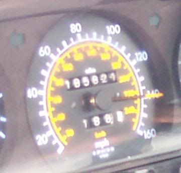

On my 2.6 a wile ago I found the switch, it looks and operates as the EZL (pull up, turn, push back down) it had on it numbers from 1 to 9 if I remember correctly and I did play with it and on some settings the engine misfires or run pretty badly but eventually I got it right and done this
click to enlarge
You can damage your engine if you get the timeing out when messing around with the EZL. It is best left alone.
