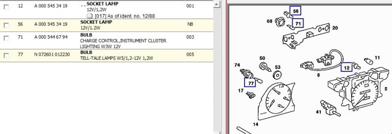

| papa | Sun Mar 28, 2010 12:46 am Post #8 |
Does this answer your questions?
| sicklyorange | Sun Mar 28, 2010 7:03 am Post #9 |
errr, now i'm a little confused.... |
| balamb37 | Sun Mar 28, 2010 11:34 am Post #10 |
Put clearly, they are all 1.2w except the ignition charge light which should be 3w. If you put stronger ones in sooner or later you will get scorching or burn damage to the plastics. Apart from the heater control knobs and they should be 0.4w.
