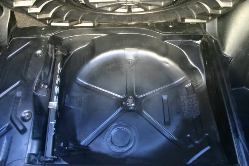

I've had seven 190s and the boot has always either been painted in a dark grey or satin black. I had to carry out some minor repairs to the spare wheel well on a car I currently have, so I removed the inner liners and sprayed the boot with satin black, which was a pretty good match for the existing boot floor paint. See picture below. A word of caution. Make sure you use a primer before the top coat - for some reason the original paint seems to react unfavourably to some rattle can paints - even acrylic based ones.

Thanks for that, and the pic. Well that looks good actually, that satin black looks a lot better than a full gloss finish. I may just go down that route myself. Thanks again. |
