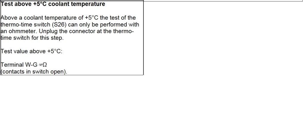

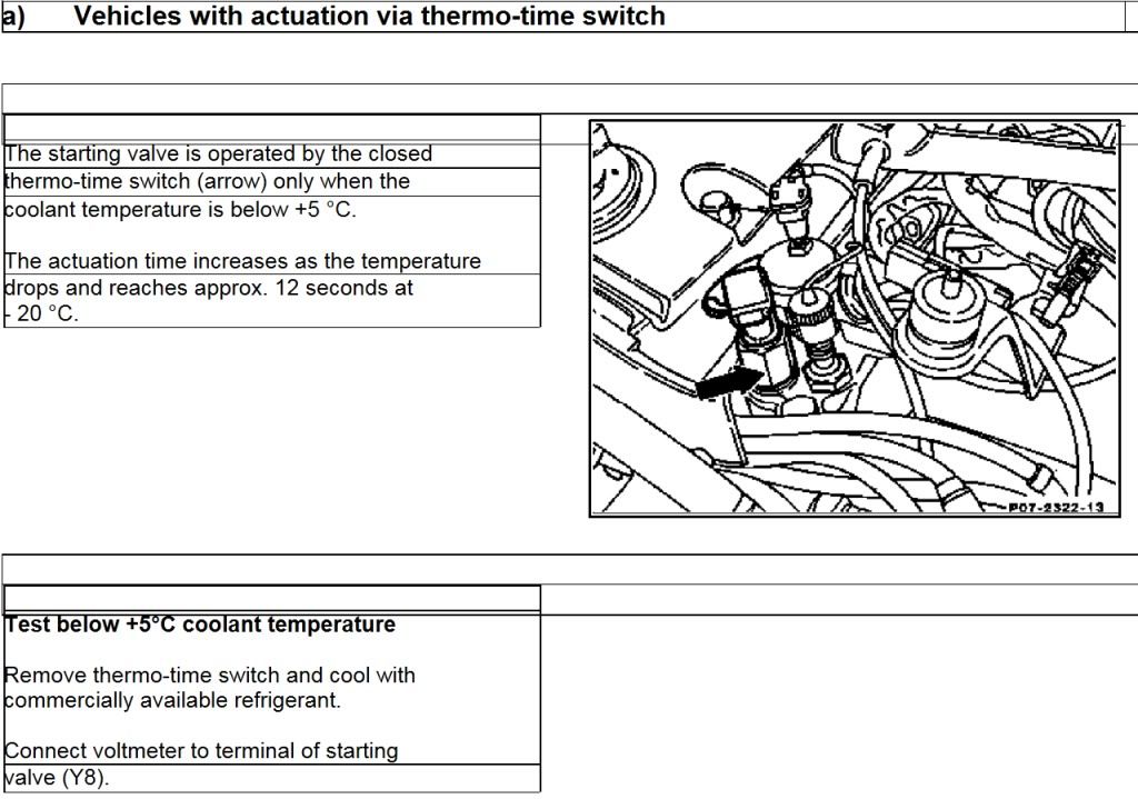

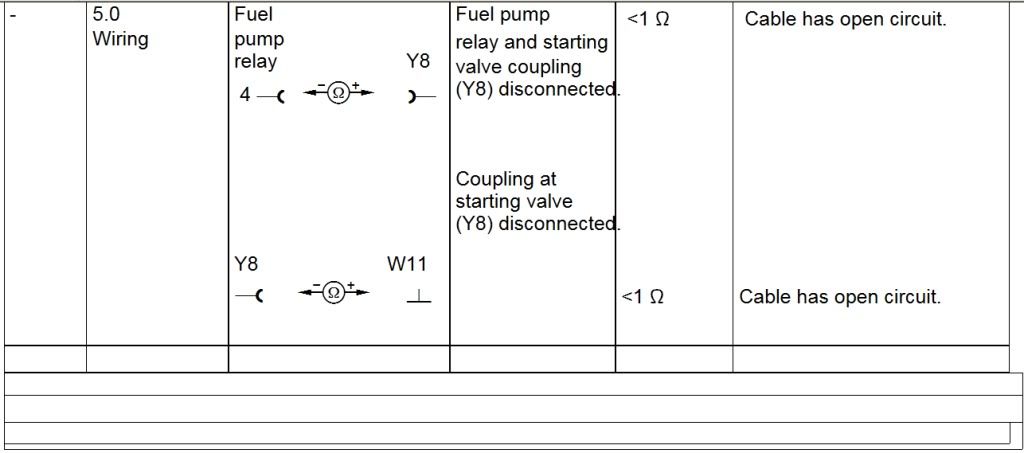

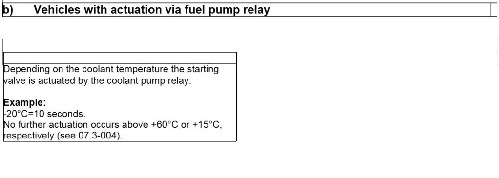

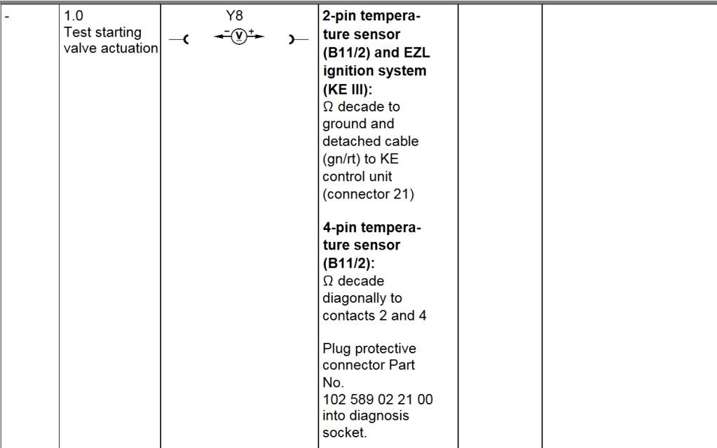

Welcome to the Forum ..A starting time of 3 to 4 seconds for the KJetronic is not unusual according to the WIS manual..maybe your cold start valve isn't working properly..??
It's supposed to put an extra charge of fuel into the intake for about 10 seconds I think so that might explain why its a bit sluggish at first..?? i'm no expert but it may be a good place to start..??
