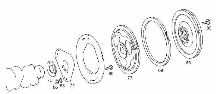

Hi everyone, just wondering if anyone has fitted a normal flywheel instead if the big heavy dual mass thing. I'd like my engine to be abit more revvy and I recon that's a good place to start but not sure of the complications to changing it... Cheers |

Don't know if its a dual mass but the flywheel weights 9.4kg and the ring gear 2.1kg

Just checked the weight for a 2.5 diesel and it weights exactly the same |

very doubtful , its dual mass, only 4 pot i have seen stripped so far is a 2.3 16 v and it's a standard flywheel. dual mass flywheels are expensive and troublesome. did one on a bravo 105jtd recently , absolute pig of a job. only to find out afterwards i could have used 100jtd standard flywheel and clutch (half the price) id avoid reman'ed dual mass flywheels,id reckon half the lifetime or less. Dual mass flywheels dont like lively launches / high revving and slipping the clutch. you'll wreck it . i think they are one of motorings bad ideas. and seemingly alot of manufacturers reverting back to standard flywheels. Edited by blankcanvas, Mon May 31, 2010 1:45 pm.

The 1.8 engine comes with a Dual mass flywheel. What I know is that Dave Irl did replaced the dual mass on his 1.8 with a 2.3 16v one in order to get more bite from the clutch. He fitted the 2.3 16v and replaced the spigot bearing too. |

karlos , just found out input shaft lenghts vary between solid and dmf ,so you might be stuck with sticking with dmf. |
