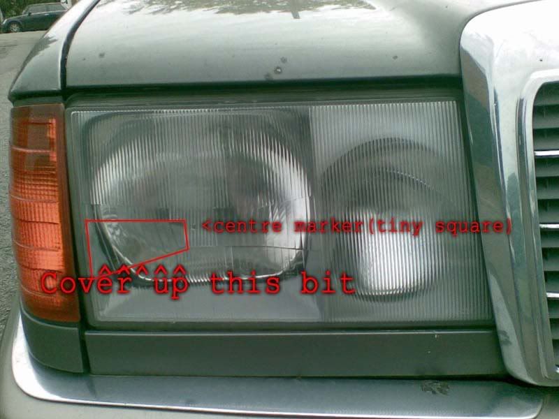

ok, here ya go. Last time I looked the sticky from my last trip was visible over the whole area, but some of it has come off so OI photoshopped it. If you look roughly in the middle of the light you will see a tiny square, almost looks like a chip. The is where the top right of the converter goes. Coming down and to the left from that tiny square you see a funny triangle shape in the lense.. Thats the bit you cover with the converter. ![]() The other headlight is the same, ie, they are no symmetrical, it goes on to the left of the tiny square as well. |
| kentronix | Thu May 20, 2010 1:03 pm Post #5 |

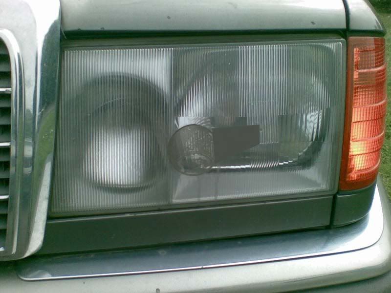

and one more for luck:-![]() This is how I have always fitted them and not had a problem, it was based on the instructions. Normal disclaimer, if you run over a frenchman it aint my fault
