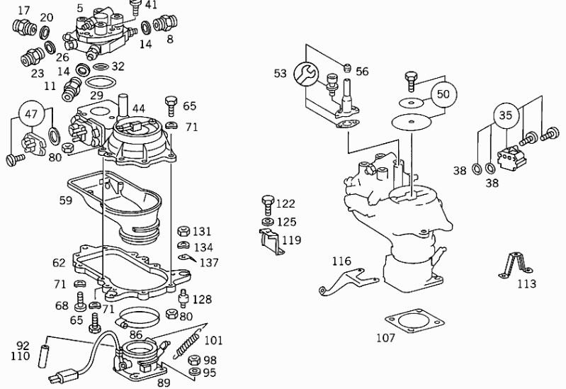

Hi learned members, i actually posted this in the wrong section first,whoops.Anyway,can someone advise me whether replacing the throttle body is a complicated job,or can a novice like me do it?Will i need special tools? Is there any possibility of doing serious damage to the engine?A garage was supposed to do it for me yesterday but i was let down.Now i`m thinking about having a go myself.Rick1 advised me to do it myself,but i`m a bit unsure.Hs anyone done one these recently? Sax. |

Hi Sax, Do you want to take off the complete inlet manifold/injection or just the Mix Control Unit..?? ![]() ![]() ![]() ![]() ![]() Does this help..?? Cosser..!! Edited by cosser, Sun May 23, 2010 3:04 pm.
| Sax | Sun May 23, 2010 3:56 pm Post #5 |
Hi Cosser, it`s just the mix control unit that i need to replace.Thanks very much your post is a big help,i think i should be able to manage it now.Is there a gasket between the unit and where it sits? My car is a 1.8 the replacement throttlebody is from a 2 litre,will the settings be the same or close enough? i will get the whole thing set up properly anyway. Cheers, Sax. |
| cosser | Mon May 24, 2010 5:09 pm Post #6 |
Hi sax, I don't think there's a gasket..?? as for the settings being the same I don't know..I think that's going to be a trial and error job..lol..!! I've had my mix unit off and it's not a huge job..just make sure everything goes together airtight..no leaks..!! Cosser..!! |

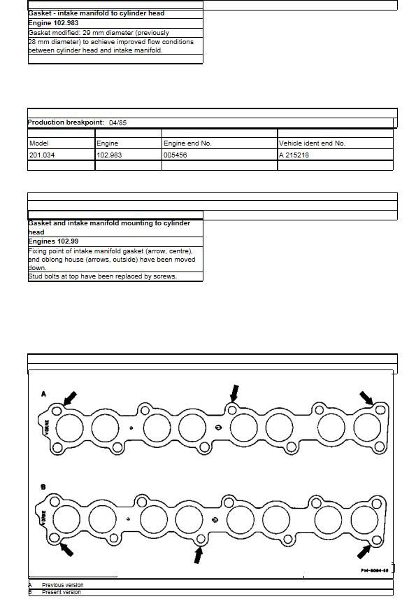

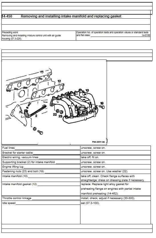

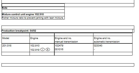

| papa | Mon May 24, 2010 6:00 pm Post #9 |
This should answer your question regarding gasket.
