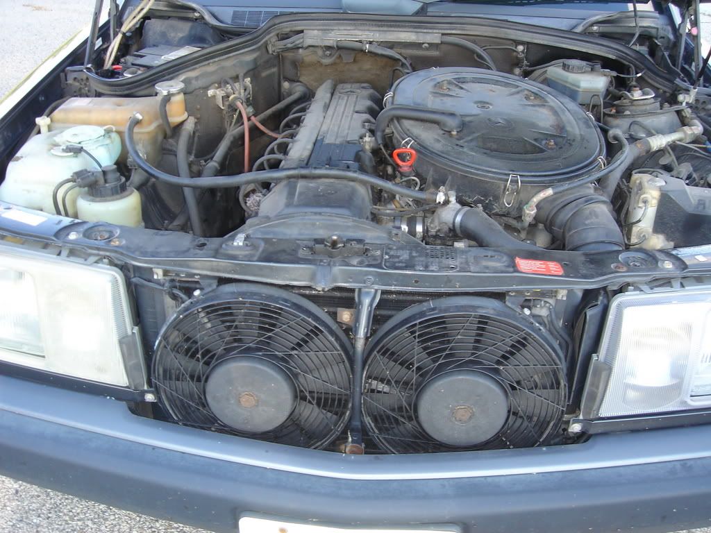

Hey mates, my 2.6 had two electric fans in front of the rad, plus the engine driven one. It was that way when I bought the car, or am I missing something here?
Edited by Drivinthebest, Fri Jun 4, 2010 9:33 pm.
