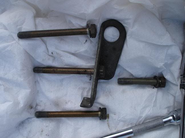

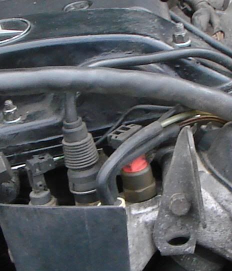

Has anyone got a picture of where the front engine lifting "eye " bracket fits on the head. I took loads of photos before i started to take everything apart but apparently not this. I bit the bullet and bought an engine hoist this week and now want to get on with the job. Thanks keith |

![]() Hope that helps - right by the thermostat and coolant block. Will |

Hi Keith, The housing doesn't support the weight of the engine, that bracket is bolted directly to the head - the bolts are longer and just pass through the housing
| Will | Sat Jun 5, 2010 11:33 am Post #5 |
Might help a bit more:![]()
