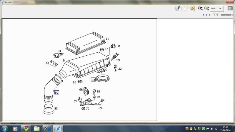

They never shared the part number so the filter housings are different. The seal ring(23) that goes between the AFM and filter housing has got the same part number on the 2.3 and 2.5 so its safe to say that the AFM's are the same diameter.
Chris Martens
They are different.
The cover of the housing is higher for the 2.5-16, the hose (part no. 80) is wider at the housing side (furthermore the the hose for the 2.5-16 is NLA) - while the inlet trumpet (part no. 83) is the same for both.

zhenya
Slightly off topic - but where can I access that parts schematic? That would much easier than me trying to identify the parts by name...
papa
