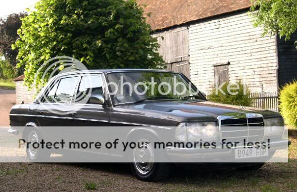

OSIRIS V8
Hi all and "blankcanvas"
This little toy is what we call our developement vehicle and is still a work in progress.
As far as we know its the only manual v8 ce so far but hope it will be the first of many !
While we are building it on a tight budget,we use it to test experimental conversion parts.
And yes it goes like hell !!.It also has a sound like a lambo that you can make great sound tracks
without having to drive fast.
Originally it was fitted with a long s class diff (2.24) that returned 38 mpg on a long run if you dont
let temptation get the better of you.On the down side this ratio doesnt line up with speed limits so
you are always having to drive in the next gear down.Now it has another s class diff of (2.65:1)
with lsd.1st gear is still very long and the accelaration is even better.Ive upset a lot of very
expensive sports cars on major roads with it!Now on a run it returns 33mpg.I use it daily around
Devon lanes and hills and average 30mpg,thats even while not hanging about overtaking like a
superbike.Its also great fun in garage forecourts and high streets as when you press the start button
it burst into life with a near seizemic event that gets everyones attention.Doesnt matter what kind of
day Im having,pressing that button always puts a smile on my face !.
Blankcanvas will soon take delivery of his 123 560ce manual,another first as far as we know.

OSIRIS V8
Hi stwat,
Everyone under estimates the 117 engine and goes multi valve (no offence).The first and most important factor is the manual box.As 126's are getting on now,very few have a tight autobox so the engine is often reving waiting for the torqueconverter to catch up.The manual box is also alot lighter than an auto.Another advantage is cornering as the car isnt floating around a corner in freewheel.Another mod is using a series 1 distributer on a series 2 engine moves the peak of the torque curve down by nearly 1000rpm and makes replacement ignition modules a lot cheaper.
Although the engine has a large displacement,because the tourqe is available from 500rpm,a long legged diff can be used making the volume of fuel/air mixture used less than higher reving smaller engines.70mph is 1500rpm in 5th.Only having one camshaft on each cylinderhead also reduces the energy lost driving mechanical parts.
Ive also done away with other power sappers like aircon and the large cooling fan.Ive resisted the temptation of electric seats as that adds about another 20kg per seat.
The exhaust system is all stainless including the manifolds so not only does it sound amazing but again its much lighter than a standard sysyem.The bore is also balanced for maximum flow with minimum internal surface drag.
So far I have found that anything that increases power except multivalve also inproves fuel consumption when driven normally.(driven normally) in this car is about 20mph faster than most normal modern cars so unless you have a clear road infront of you,the car spends most of its time being held back.
We are currently experimenting with the later injection system to make engine more tunable and with much greater airflow for more power at higher revs.We are also playing with a new type of forced induction that doesnt have the back pressure and tempretures of a turbo and doesnt take energy from the engine like a supercharger.When we get it working properly it will pump in air at 2 degres c while only drawing energy during decelaration.The system princeple works well but we still have alot of work to do on the control mechanism.

I dont think you will get an answer from the owner Rambo as the last post on the thread before you ressurected it was 11 months ago.
I wonder if any of the other techs on the site will know?
I'm asking because currently I'm doing M119 conversion in 190E, I plan to use SL300-24 5spd dogleg manual gearbox, and I'm making an adapter plate, as far as I know M117 and M119 share the same bolt pattern on the bellhousing and I wander what gearbox did he use, because I'm not aware of a manual transmission for those engines..
Paulossie
Potato
Is it possible to convert a 92 300 or 500 sl to a manual if so what kind of cost are we talking and is it possible to pop down to Devon and have a chat about it some time, if so can you pm me or post your details please.
Cheers Paul
Lambo_Rambo
Paulossie
Mon Jan 16, 2012 9:45 pm
Cheers Paul
I didn't understand if you were talking to me?.. R129 SL300-24 came with an manual (optional) 5 speed dogled non-getrag transmission, code 717.451, the same as 717.450, which was installed in W124 300-24/320, the 500 is different bellhousing bolt pattern, and I'm not aware of a manual transmission for that engine (M119)
Paulossie
Potato
Lambo_Rambo
Mon Jan 16, 2012 10:34 pm
Paulossie
Cheers Paul
No it was directed to Orisis v8 cheers.
